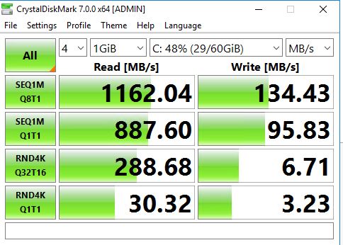

here is the current disk performance

I'm stuck trying to figure out why its being recommended another product. I was able to improve my performance by over 500% via identifying a mistake in deployment. I had a Cache device, and a LOG device. The LOG device was an SSD (same as the rest of the pool) and the cache was an Optane device. Once swapped, performance improved
