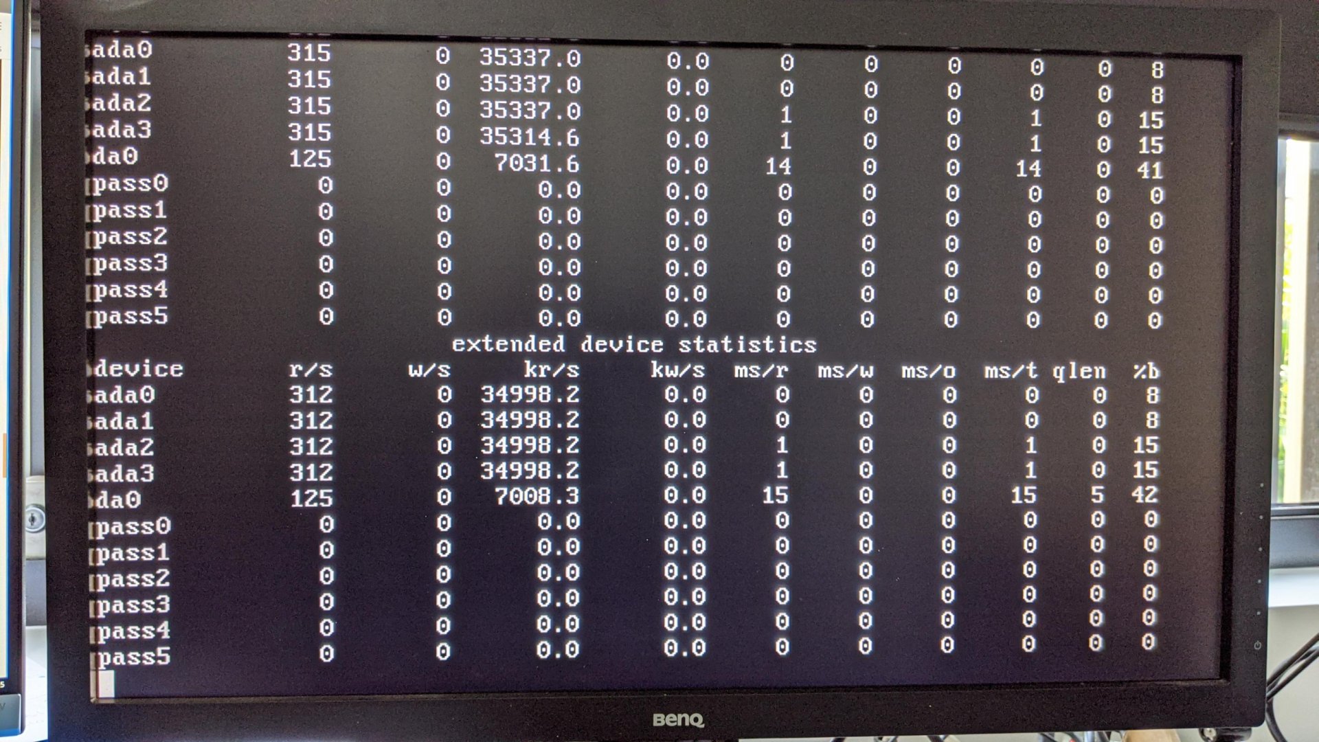

From the BUI it does know about my encrypted zpool, but for some reason the system seems to be doing a scan or read of some sort because it seems that zfsd is reading those disks to the tune of ~34MB/s and has since it booted ... I haven't entered my encryption key yet, so I don't know what it thinks it's doing ... the zpool isn't available, so it's unlikely to be a scrub ...

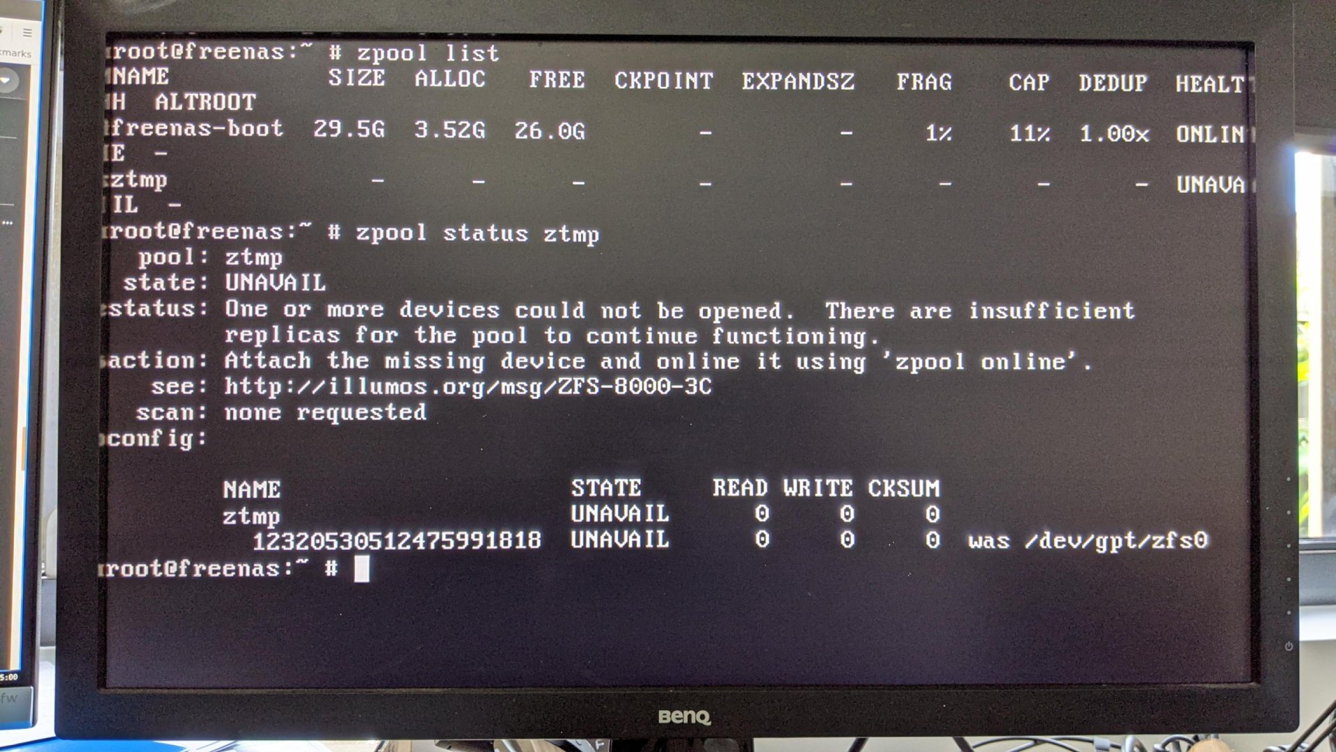

There does seem to be some cruft from the ztmp pool still around - zpool status and zpool list both report the old disk from the CLI console and I can see that it's also in the list of disks in the BUI but for the moment it doesn't seem to be impacting anything, so I'm leaving that alone for now.

did some trussing of the zfsd process and found that it was spamming /var/log/messages with 'ZFS: vdev state changed, pool_guid=975482569780627184 vdev_guid=12320530512475991818' which matches the vdev uuid for the ztmp disk, so I thought I'd try a 'zpool export ztmp' and after that it seemed to clear things up and create the swap GELI devices as below ... also, IO on the system has dropped to nothing, so I think it was just continually trying to import ztmp from that missing USB2 disk and was stuck in a loop ... haven't looked at the BUI yet to see what that's saying

the USB2 disk is still listed in the BUI pane for disks, but on the console zpool list and zpool status don't mention it at all, so I think the BUI artifact is just that - will reboot and see what things look like coming up again after that
