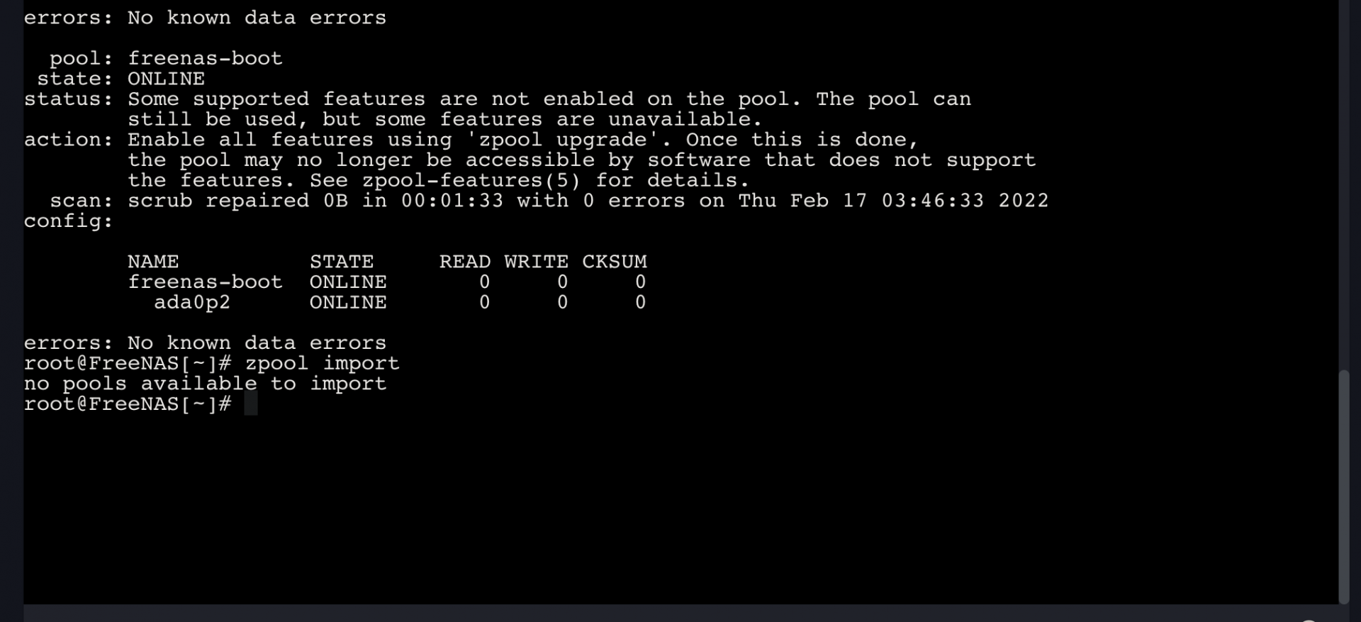

What's the result of:
zpool status
zpool import

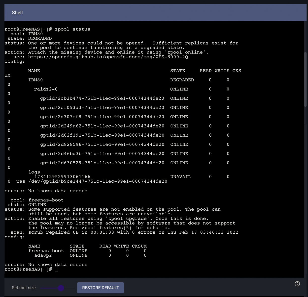

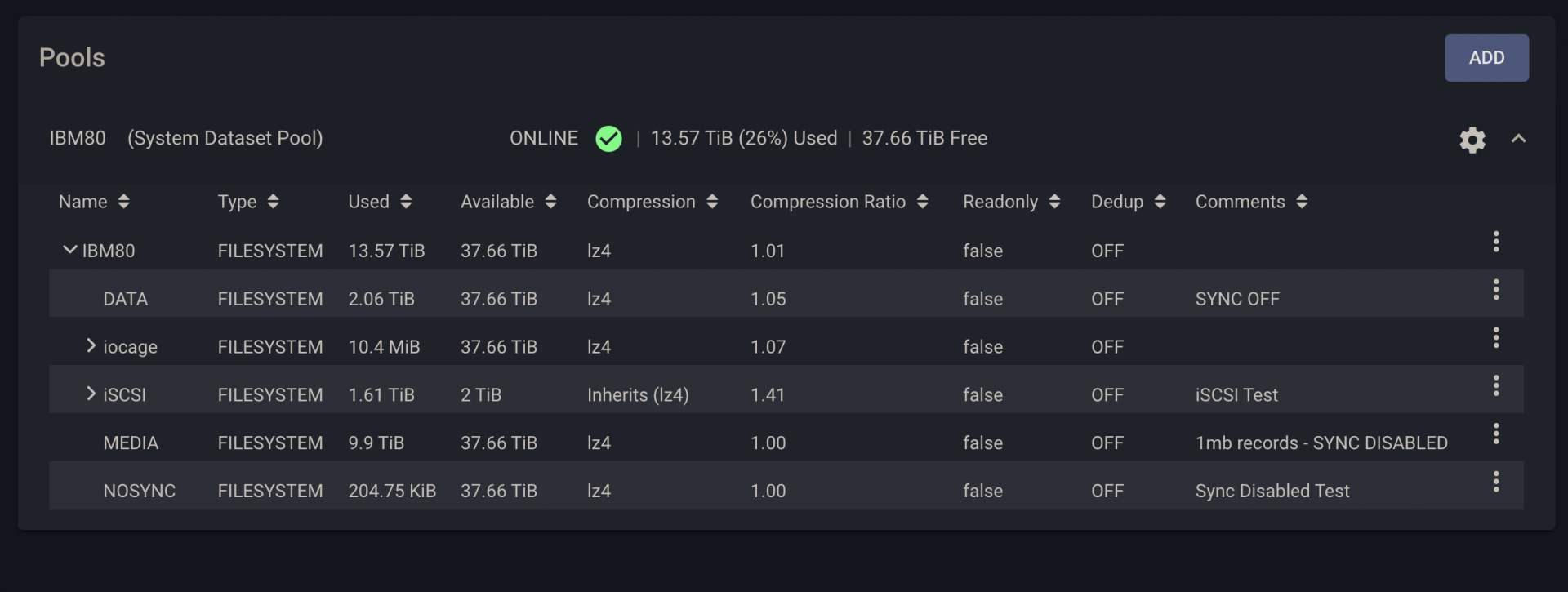

I actually only know how to take screenshots ... (can't seem to copy the text and even if I did it'd lose it's formatting and being a wall of text I'm sure) ... hope this is okay -- consolidated it in photoshop to hopefully make it easier for you to read:

1. Always use ssh to get at the command line and not the web UI shell. The latter is broken, period.
2. The pool "IBM80" is already imported. Why do you want to import it again? The initial error message just told you that a pool named "IBM80" already existed. Nothing is wrong with your pool. Of course the slog is gone, but apart from that the pool is healthy.
3. You can remove the slog with zpool remove IBM80 <that long number that I am not going to retype from a screenshot>. Use ssh, then use copy & paste.
4. You did not type zpool import and show us the result.
Patrick M. Hausen
Nov 25, 2013
7,776
OK, so the two commands give consistent output. There is no pool still to be imported. The pool "IBM80" is imported and healthy. You just need to get rid of the slog device.
What is your problem that sparked your initial post, then? Anything not working as it should?
