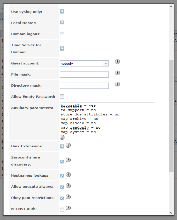

In your SMB configuration, you may want to add the following Auilary parameters:
browsable = yes
ea support = no
store dos attributes = no
map archive = no
map hidden = no
map readonly = no
map system = no
I have been using these for several years now because they were supposed to make access time faster.
