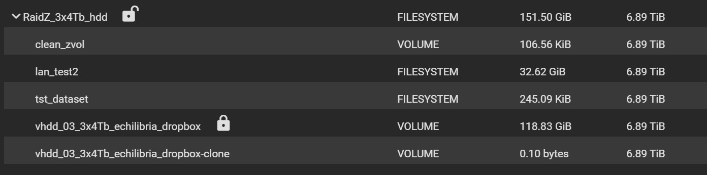

My problem is as follows :
I have 2 Truenas 12 servers.
I want to move some zvols from one to the other.
I used replication to move them but on the new server they are locked and I can't see any option to decrypt them.
Then I replicate a dataset I have a "Unlock" button which works great.
The question is how can I unlock the Zvol
I attached a picture with my pool. I want to unlock the "vhdd_03_3x4Tb_echilibria_dropbox " volume (zvol)

Update on this:
Using the shell and doing a:
zfs load-key <Pool/name>
resolved the problem. After doing that, you are being prompted for the hex-passphrase, which you should have. After entering the correct one, the lock is being removed and you can use the volume.
Hope this can be of help for anybody!
