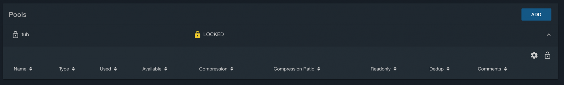

Hello,
About a year ago, before getting lost in the COVID response, I had a functioning FreeNAS system for home backup (mostly photos, videos and time machine backups). At some point my boot drive failed, and the system never came back up from a reboot. Now, I can't access my main pool, "tub"
I'm don't recall ever encrypting my data. I did use compression but remember thinking that encrypting the devices was a bad idea. I don't have any geli.key's saved and I don't have a passphrase saved in my password manager. However, as I've been troubleshooting, I keep on coming back to the conclusion that maybe the drives are encrypted which is I why I can't import the pool.
Based on other threads, I did the following troubleshooting. Does these data confirm that they are in-fact encrypted? I'm hoping not since I have a failed boot USB and no geli.keys or passphrase. Is it possible that there are zfs feature flags that 11.2-U8 still doesn't support that would be cause the pool to be "locked". Truthfully, I don't recall which version I was on when the system was working pre-pandemic meltdown.

The system sees a "locked" pool called "tub". Again, I didn't THINK I encrypted the disks and don't have keys or a passphrase saved anywhere.
I concur with @danb35 , it appears that your pool was encrypted. This is bad news because the purpose of encryption is to keep the data safe from anyone without the key. It is extremely unlikely you will be able to access your data again, unless you can find the key / passphrase.
