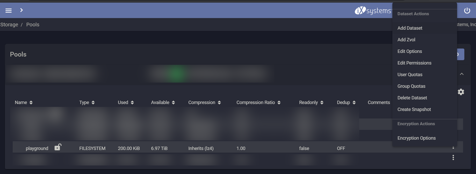

I can understand the justification for preventing the top-level root dataset from being locked if the System Dataset (.system) resides on that pool. Hence, why TrueNAS prevents you from moving the .system dataset to a pool in which the top-level root dataset is encrypted with a passphrase.
Why did they remove the option to "Lock" a dataset that doesn't use a passphrase? I think it's an artifact of how it was designed with handling GELI (legacy encryption) from version 11.x and earlier. There's no logical reason for preventing a user from locking an encrypted dataset that uses a keyfile instead of a passphrase, aside from the exception explained above in regards to protecting .system.
In the above screenshot, there are no child datasets nested underneath "playground". The dataset is encrypted, using a keyfile.
