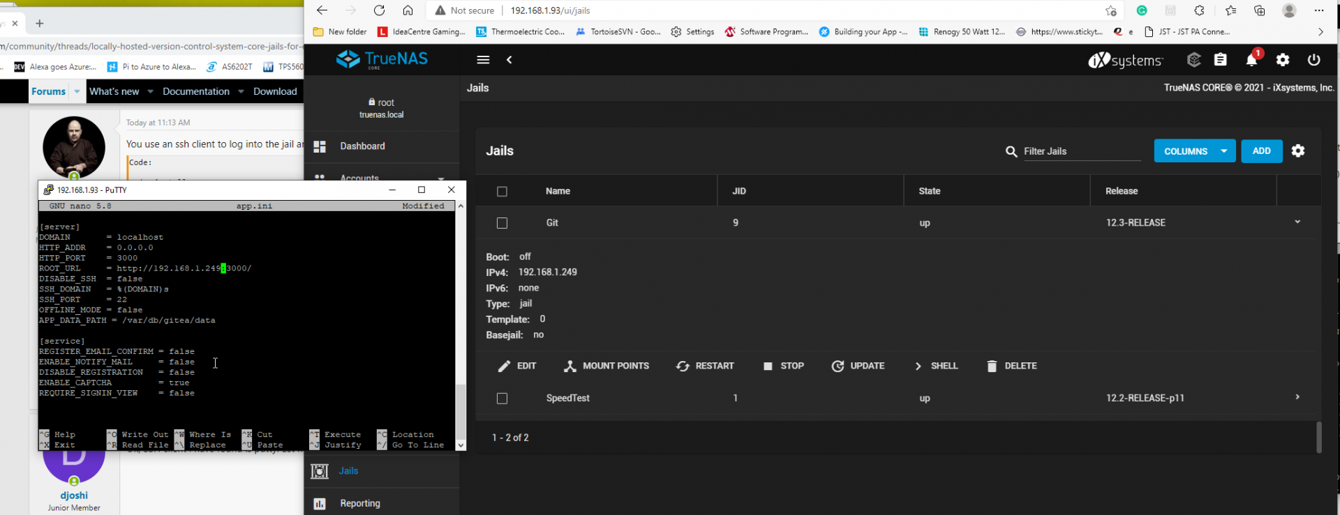

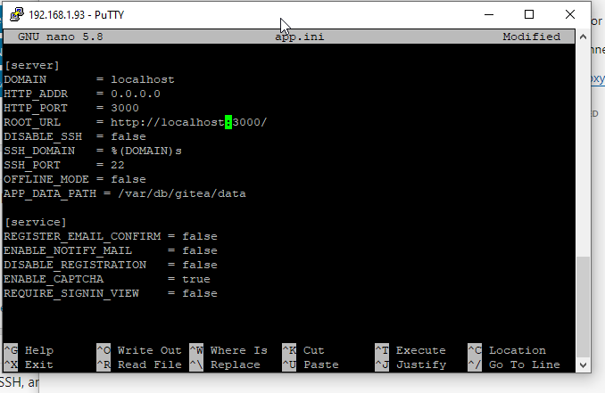

Hi Thank You for your help
SQL is set back to 127.0.0.1
In regards root URL, should this be the same as JAIL IP address.
I aim to set HTTP_ADDR to 0,0,0,0, so what every my JAIL IP ADDRESS is , that should be my GIT server. So do i need to set ROOT_URL back to localhost?
Does this look correct?

Root URL = jail IP address, if you want to put an IP address in your browser instead of a hostname.

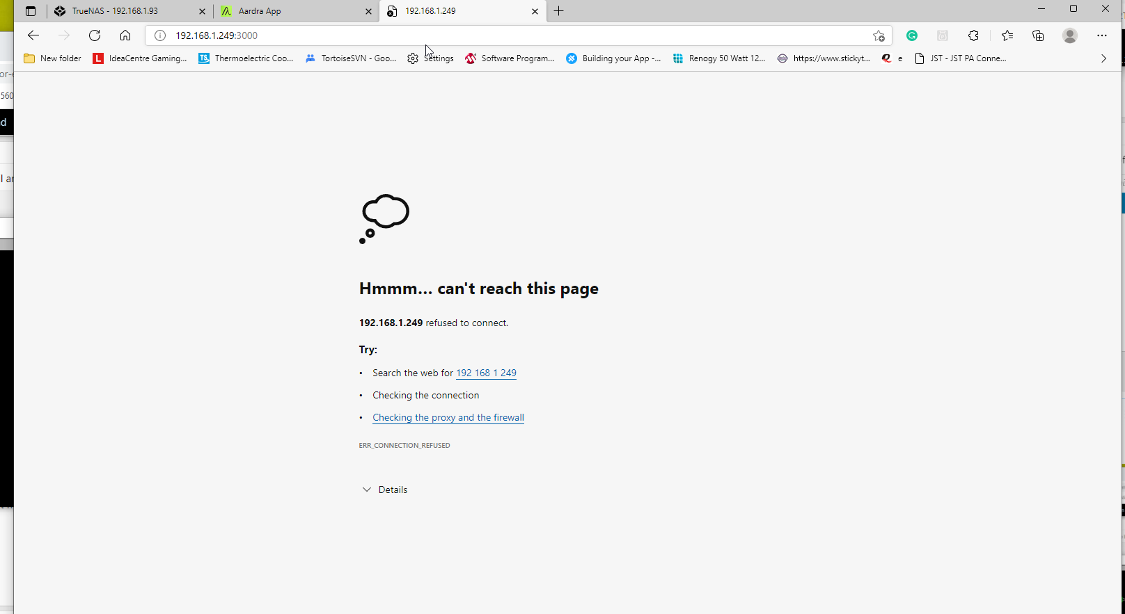

Please don't post pictures of your putty. Copy & paste the text inside the terminal window enclosed in code tags.
Your question: what does service gitea status say? Did you do a service gitea restart after you edited the configuration?

Sorry,
This is what is outputted in putty
root@Git:~ # root@Git:~ # service gitea status
root@Git:~: Command not found.
root@Git:~ # Cannot 'status' gitea. Set gitea_enable to YES in /etc/rc.conf or use 'onestatus' instead of 'status'.
Cannot: Command not found.
root@Git:~ #
15,504
Is the jail called Gitea or Git? Last night it was Gitea; today it's apparently Git. And if you've destroyed and recreated the jail (with a different name this time), did you run sysrc gitea_enable=YES after the new installation?
Patrick M. Hausen
Nov 25, 2013
7,776
There's the solution: edit /etc/rc.conf and set the variable accordingly or use sysrc:
sysrc gitea_enable="YES"
service gitea start
