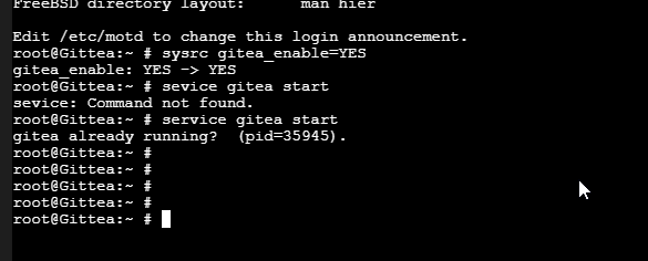

I created a Jail and enabled ssh using "Services". Then using the "Shell" I typed pkg install gitea.
It has been installed, but how can I verify that it has been installed correctly?
When I go to the IP address, I was expecting to see a git page, but I get
Hmmm… can't reach this page​
192.168.1.198 refused to connect.
15,504
Did you enable and start the gitea service, as the docs that Patrick linked tell you (and tell you how) to do?

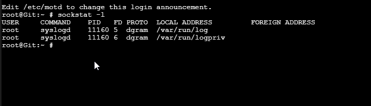

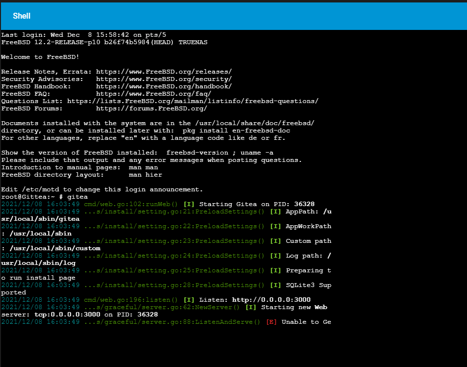

I am also getting the following , if it gives any indication what could be the problem
15,504
Do i need to go to certain port with gitea?
Looks like it:
root@gitea:~ # sockstat -l
USER     COMMAND    PID   FD PROTO  LOCAL ADDRESS         FOREIGN ADDRESS
git      gitea      14474 12 tcp4   127.0.0.1:3000        *:*
root     syslogd    14004 5  dgram  /var/run/log
root     syslogd    14004 6  dgram  /var/run/logpriv

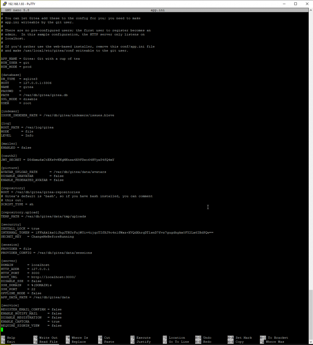

Also looks like it's only listening on 127.0.0.1, so you'll need to edit its config file (in /usr/local/etc/gitea/conf/app.ini) to listen on your jail's IP address.

Once again, sorry for my trivial questions, but how do i get to this file to edit in TrueNas?
Patrick M. Hausen
Nov 25, 2013
7,776
You use an ssh client to log into the jail and a text based editor. If you don't know vi, you can use e.g. nano:
pkg install nano
rehash
nano /usr/local/etc/gitea/conf/app.ini
service gitea restart

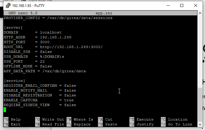

Ok, I have manged to get something working with SSH and Putty. This is what I am seeing on SSH. There seems to be two IP address one for the server and one for the database. If i am correct i need to change the HTTP_ADDR only?

So ROOT_URL should be 192.168.1.249 and not local host?
What about the SQL database IP address should it also be 192.168.1.249?
Patrick M. Hausen
Nov 25, 2013
7,776
Yes the ROOT_URL should match the IP address you use to communicate with gitea. Or better the hostname. If you run some internal DNS, you can create a hostname for that IP address there. Or you can install ahavi-app inside your jail and use gitea.local as the hostname. So whatever needs to be in your browser's address bar to access gitea - that's the root URL.
When you put 0.0.0.0 into the HTTP_ADDR gitea will be reachable by whatever IP address the jail has so you don't need to maintain that in two places.
The SQL database IP address is the address of your SQL server as used by gitea. Nothing else is accessing that database. So 127.0.0.1 is perfectly fine if the SQL server is in the same jail as gitea itself.
HTH,
Patrick
P.S. The idea with putty etc. is that you can copy and paste the text instead of a large screenshot. Please try to do that for future posts.
