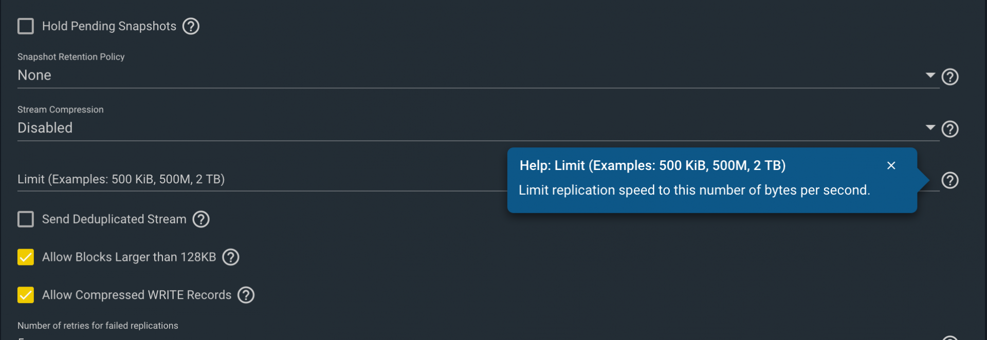

Are you looking at the advanced replication setup?
Alecmascot
Neophyte Sage
Mar 18, 2014
733
Tasks --> Replication Tasks --> Add --> Advanced Replication Creation
11.3-U2
Wizened Sage
4,923
is it not possible to add limit after adding?
It's more a question of old replication jobs prior to 11.3 not being the same. You may need to create a new one to get the settings to work right.

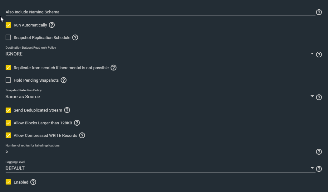

Dariusz1989
Member
Aug 22, 2017
181
I just made this job :/ ehhh freenas!!!! I guess my gui was "old" nad he made it using old method... could explain why the job dissapear yet its still active for pat 7h!
