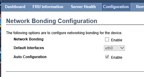

I think I know why. On Supermicro boards the IPMI is bonded with the Intel NIC. I had the same issue on an ASRock when I wanted to use link aggregation. You need to break the bond in the IPMI and set an IP on eth1. That should allow it to work.

I'm 99.9% sure eth1 isn't IPMI. My board has 1 IPMI NIC, 2 normal NICs, and a 4-port NIC expansion card.

When I say eth1, that is within the IPMI configuration, not FreeNAS. In my IPMI I had a 'Network Bonding' configuration item. This is what I had to disable in order for link aggregation to work in FreeNAS. I had the exact same symptoms when I connected the second NIC it would lose connectivity.

Hmmm, the closest thing I can find to this in the IPMI is "LAN Select Setting", and it's disabled. Which I believe means only use the dedicated IPMI port for IPMI. The only stuff under Networking is DHCP and VLAN. :(
