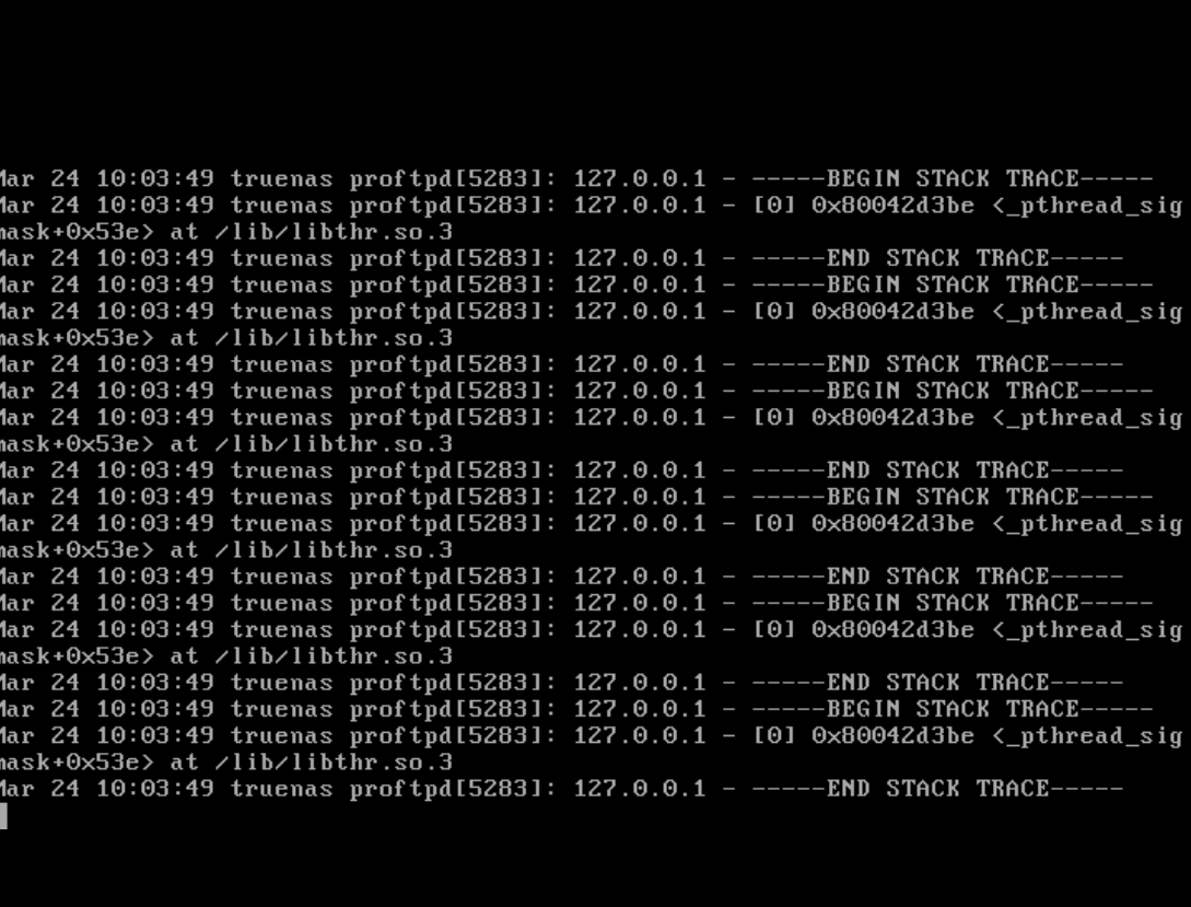

Additionally, from the iDRAC: when I rebooted and just idling clicking through the WebUI

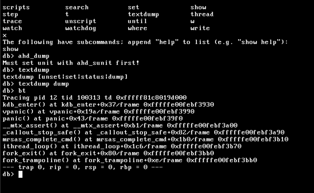

Do I then reboot into normal kernel and pull the log? New to FreeNAS and not sure.
ismith.hpu
Mar 24, 2020
11
There is no difference in the two files unless I pulled the debug_kernel logs incorrectly.
Is there a guide or resource you can point me towards in assisting you guys helping me?

This is a completely different panic. Since you're having crashes with every version of FreeNAS, maybe this is actually a hardware issue?
