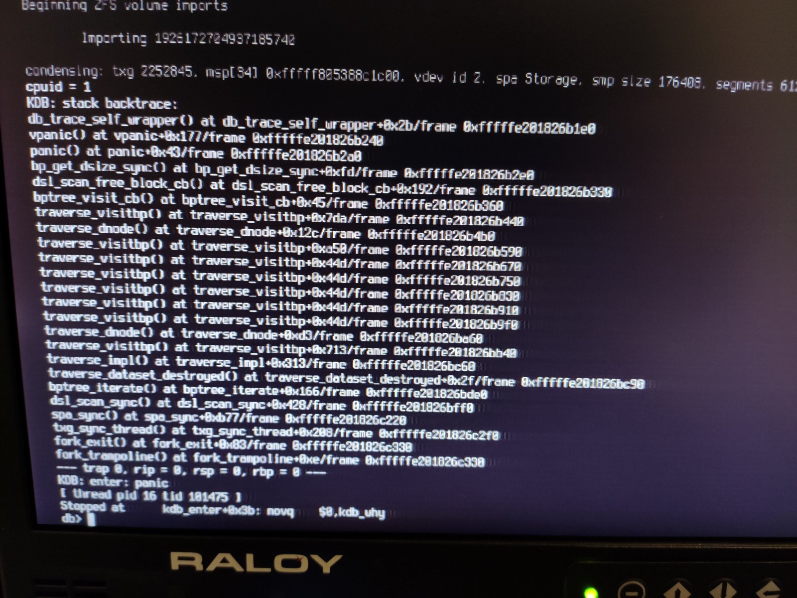

The backup seems to have taken a dump. It seems to have completely crashed and now fails to import the pool on boot, dumping to a db> shell. Image for reference. The db shell doesn't seem to allow me to do much.

What are you using for the boot device? It is quite possible it failed.
gamebrigada
Jul 9, 2019
12
I can boot into single user mode just fine, and import the pool in read-only mode works fine. No issues reported. Won't mount but I'm assuming that's because its in single user mode? Dropping the read-only flag results in the same error.
