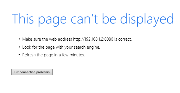

If i go to the webgui of SABnzb then i get the message that it isn't reachable
(http://192.168.1.230:8080/sabnzbd)

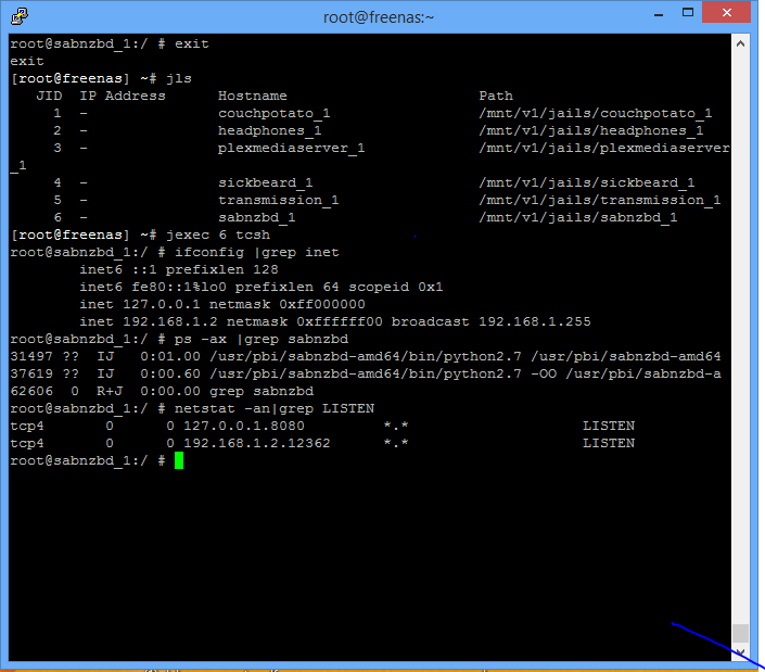

Verify the LAN IP's and that the service is running on the right ethernet interface/port:
jexec 1 tcsh                             This is to log into your sabnzbd jail.
ifconfig |grep inet                      This is to check IP address.
ps -ax |grep sabnzbd                      This is to check if the service is actually running.
netstat -an|grep LISTEN                  This is to check if it is listening on the correct interface and the right port.
You can repeat the steps above for the transmission jail also.

I did verify the service with the given commands but it looks like i can't see any ports with netstat.
So still no luck :(

Those outputs look good. It seems like there is a listening service at port 12346 (I have never used sabnzbd unfortunately), so I don't know if that's the correct port. Someone else may be able to verify for you.

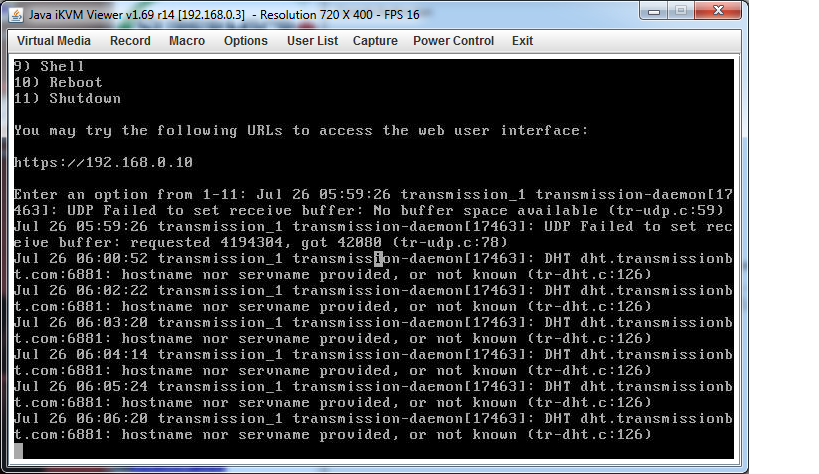

EDIT: Looking through the log and I keep seeing this command keep repeating itself. 192.168.0.50 is my laptop ip
2014/07/26 04:47:58.856194, 0] ../source3/lib/util_sock.c:1199(get_remote_hostname)
Jul 26 04:47:58 freenas smbd[38720]: matchname failed on 192.168.0.50
Jul 26 04:47:59 freenas smbd[38721]: STATUS=daemon 'smbd' finished starting up and ready to serve connectionsmatchname: host name/name mismatch: 192.168.0.50 != (NULL)

Attached is right after I try to access transmission
BTW, sorry to hijack your thread OP

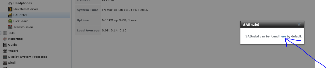

I have transmission, sickbeard, couchpotoato, plex , headphones and sabnbd installed and was working perfectly for about a week,,,, however sab is the only one that I'm not able to access via the web GUI
have included some info if that helps
I'm really at a loss and ready to give up

How exactly are you trying to access the webgui?
Brad1961
Mar 10, 2016
17
hi jj
does that help and the result
