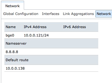

Please post a screenshot of FreeNAS | Network | Network Summary.

- screeny attached

And 10.0.0.138 is your router, obviously? I'm running out of ideas, sorry.
