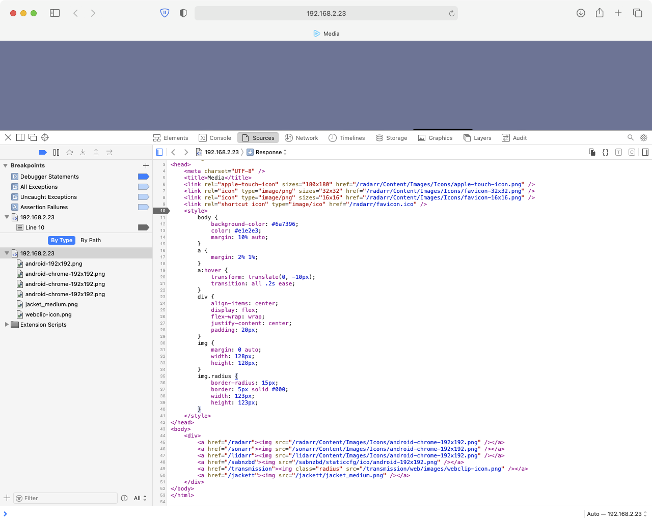

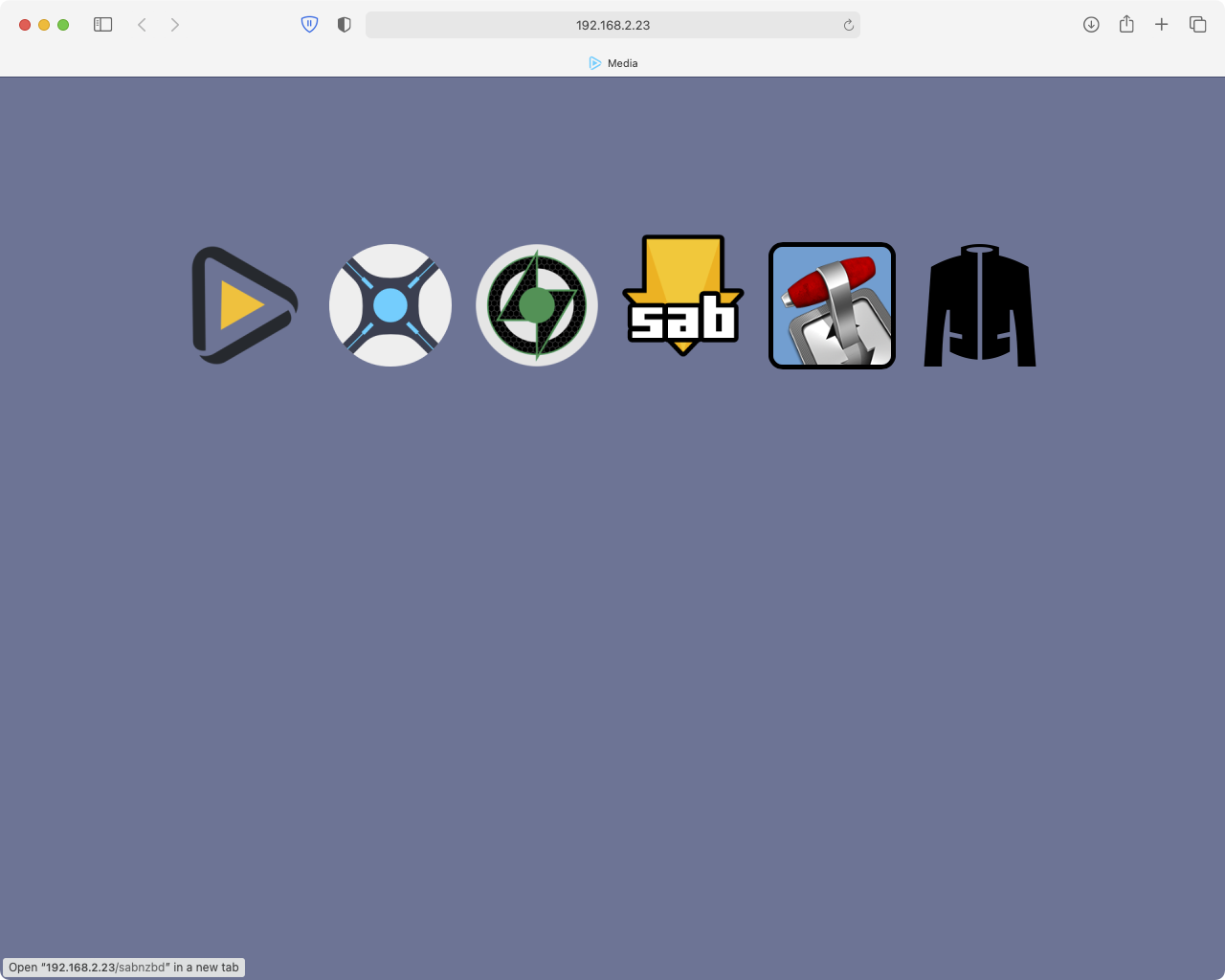

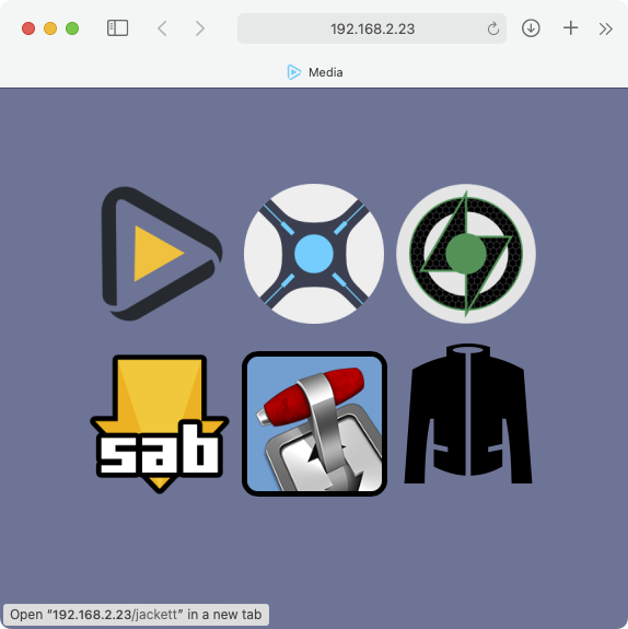

Basically, what I need is to display on an webpage the current jail server load and uptime. This is related to an automated setup of several media tools running all into same jail (which I plan to publish soon, hovering over icons moves the icon, like Apple dock icons, note Sabnzbplus icon being higher):
The IP you see is the actual jail where all above tools run. Ideally, I want to see the uptime and server load on that page. The index.html file is static and also mobile friendly, with images linked directly from applications and requires no edit:
Also, the Nginx configuration does not requires any changes, is universal for any setup, therefore it can be easily automated.

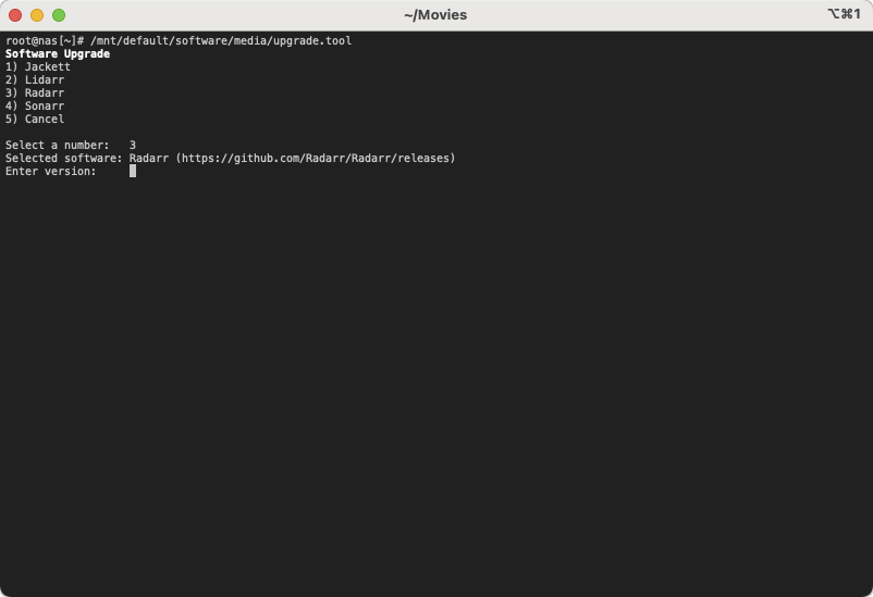

BTW, where is the best place to post the tutorial? It includes the automated install for all components using pkg (no manual install), as well a script to update the software to latest versions, you run it from terminal into TrueNAS (not jail) to execute all iocage commands:
For example, Sonarr3 is out of beta but only the Lord knows when freshport packages will be updated.
