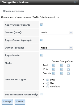

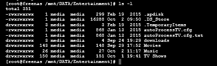

Permissions on my dataset appear to be correct:
Output of the command ls -l :
Sonarr, SABNZBD and CouchPotato all run under the media user and group and the UID and GID match between the Jails and FreeNAS dataset permissions.

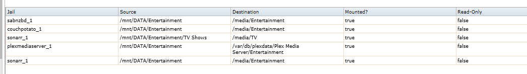

Sonarr jail has the following storage:

How did you mount the storage in the jail? Got a screenshot of that page?
15,504
That looks kind of odd--/mnt/DATA/Entertainment is mounted at /media/Entertainment, but /mnt/DATA/Entertainment/TV Shows is mounted at /media/TV. Is TV Shows its own dataset? If not, I'd delete that storage mountpoint entirely. If it is, it would probably make more sense to have it at /media/Entertainment/TV.

So in your jail the path sonarr is complaining about doesn't exist. You need to make it exist and be the location you want to import your media to. /media/TV is the path in the jail not /media/Entertainment/downloads/sab
Thanks, it's not it's own dataset, I now recall why I added this. I was having trouble adding TV Shows to Sonarr, and after trying to add the path directly it worked, I forgot to remove it, but essentially when I had it at /mnt/DATA/Entertainment, Sonarr didn't have perms to write to the /TV Shows/ folder. I'll delete it and try again.
SABNZBD doesn't download to /TV Shows, that's the post-processing complete dir so I'll need to remove it I think as above. :)

After removing /media/TV and getting the same error, I still think there is a permissions issue. Permissions on the folder 'downloads':
Yet on the files within the newly downloaded show, the permissions are different:
