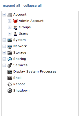

I'm new to this, but as far as I can tell, everything works smooth except that Jail is not present in my tree view (see below) and is, as I understand it, preventing me from installing applications. Are there settings that I need to change in order to make it visible or is there something else going on that I need to do?

Did you install the jail?

I thought I did. I created the Jail folder and the Jail Archive. I must have done it incorrectly. All of the other threads and forums I have read seemed to imply that although it needed to be installed, it already existed in the tree. I'll try to reinstall the Jail.
