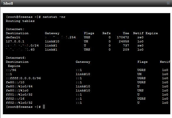

When you say you "can't ping the outside world", do you mean you can't ping a hostname? Like www.google.com? If so, can you ping an IP address (like 8.8.4.4) directly? If you *CAN* do the latter, the problem would appear to be your DNS resolution. Check your settings for that, and check in /etc/resolv.conf in your jail for anything out of place.
If you CAN'T ping anything, hostname, or IP address, then the problem is more than likely routing related. Do a
netstat -nr
in the FreeNAS itself (not the jail), and make sure the gateway settings you see under default look right.

I did mean I couldn't ping a hostname. I did what you said and it turns out I couldn't ping the hostname either (from inside the jail) I ran netstat -nr and got the following results (I've marked out my public IP just because I don't want every Andy knowing it): Everything looks ok I guess. I don't understand why the "###.###.###.0" IP is in there. The one ending in .60 is mine assigned by DHCP to the NAS box and I don't have IPv6 on my network so that's just garbage below. Now, is there a way to get DHCP to dynamically assign an IP to the jail? I think this might be my issue as my network doesn't like objects that don't use DHCP.
