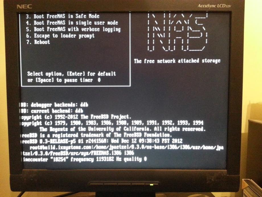

I have the latest FreeNas 32 bit installed on my pc. It only has 2GB ram so I will use UFS. The system installs sort of ok onto the USB stick (My CD gave errors during the install, but it did complete), but then during the boot process it just restarts again. It happens after the FreeNas boot menu when after it has printed the timecounter line.
Once I see that, the computer reboots.
The motherboard is a ASUS P5VDC-MX
In the bios I have set the emulation mode for the USB stick to be Hard Drive.
Do you have any ideas for my next step?

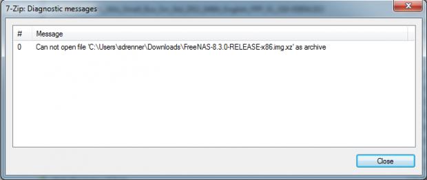

I tried installing using the link above and when trying to use 7-zip to extract I get the following error:
What am I doing wrong?
I have also tried installing from CD to USB
