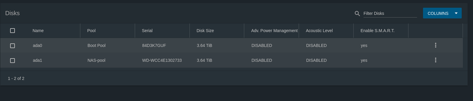

Hello,
I am new to freenas O.S. I have installed freenas on a server on 3.5 T.B hard disk and have added one more drive on the server with the same capacity. when I access freenas by browser it shows me both the hard disk under storage option but when I try to create a pool the hard disk contain O.S is not available. I need to create pool with merging both the hard disk.Please help. As there is no more slot left in server to have one more HD mounted neither I could invest a 3.5 TB hard disk just to install server.
How can i create pool using both the H.D. Is it possible to share the same drive in pool which contain O.S. if yes how could we do that. Is there a concept of creating LVM in freenas so I could keep the O.S on one partition and remaining could be used to create a pool.Kindly help. its urgent.ada0 is the one contains O.S which is shown in screenshot.but while creating pool the available disk shown is only ada1

You need a dedicated boot device. What kind of hardware has only two storage slots?

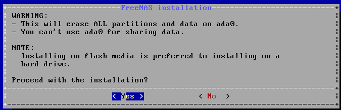

Then you'll need to use a different storage OS. FreeNAS by design keeps the OS separate from the data.
15,504
Which is a really really really important feature
...and what makes the incessant threads of "my boot device died, what happened to my data?" kind of frustrating--why do they think the devices are separated this way?
