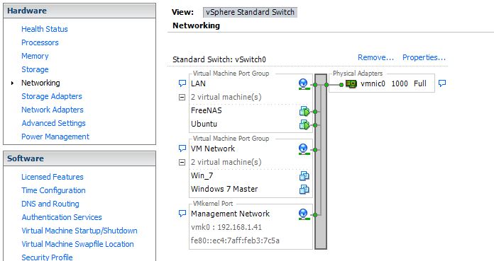

Attached is a screen capture of my ESXi 6.5 machine network setup. It's not terribly busy either so this should make it easier to follow.

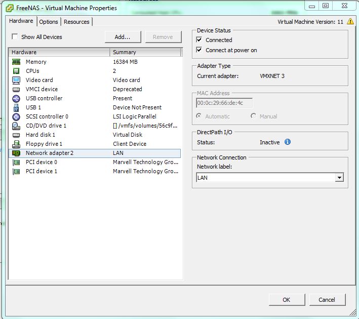

So the below image is of my FreeNAS setup, note that I have the LAN driver set to VMXNET3.
Now is the ESXi Network configuration screen capture. Note how every interface connects to the vSwitch.
My limitation when running iSCSI for my Windows VMs is my pool design, not a limitation of the VMXNET3 driver.

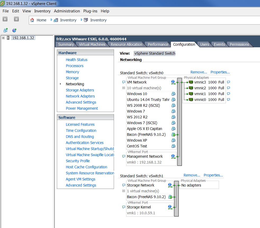

I agree with @joeschmuck, that the answer to your last question is 'No'. You're asking about an AIO (All-in-One) system, where FreeNAS runs as a VM on ESXi and provides datastore storage to ESXi via iSCSI or NFS or both. Virtual machine disk transfer rates created on an AIO system like this are NOT constrained by the network card. Instead, as you pointed out, transfer speeds are constrained by the speed of the system itself (CPU/RAM/HBA/disks). On my AIO systems, I configure a separate storage network on its own virtual switch to segregate datastore traffic from standard LAN traffic, as described in @Benjamin Bryan's excellent article.

VMware network configuration for separate LAN and storage networks:
