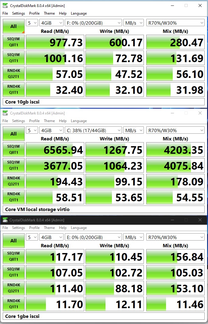

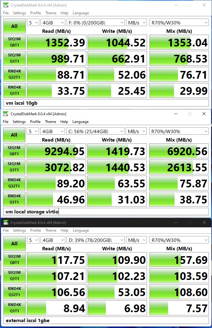

I tested with crystal disk mark including a mix 70%r 30%w setup. This going to iscsi over 1gb, iscsi over 10gb, and native on the VM running in the enviornment.
I got these results with Scale
And these are my results with core
Is there some config I need to tweak for core that these results are that much lower?

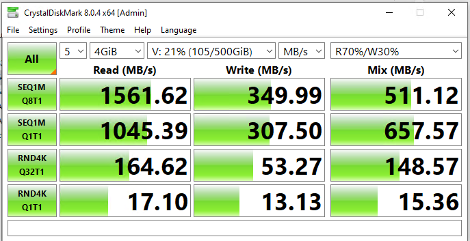

My old system which is a 6700k with 32gb ram, 6 3tb hgst ultrastar drives and a 256gb read cache gave these results (with read cache not directly comparable I don't think).
Just wondering if there is something I am missing or does this seem about right before I continue testing.
