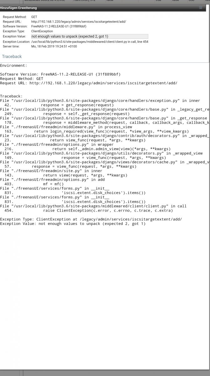

when I try to create the extend into the lagacy UI I get an error.
For the moment I use a file instead of device. The VM is just for testing and it worked well ... so far.

Find the file attached.
