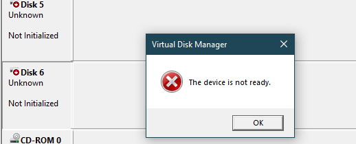

My issue is when I attempt to set up a 3rd and 4th iSCSI, windows will see the drives, but when I attempt to initialize the driver I get the error "Device is not ready".

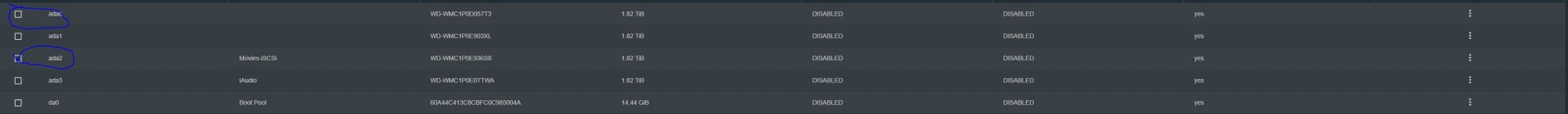

Here are the drives.

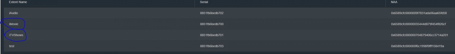

The circled are the ones that are working. ada0 is the iTVShow Extent

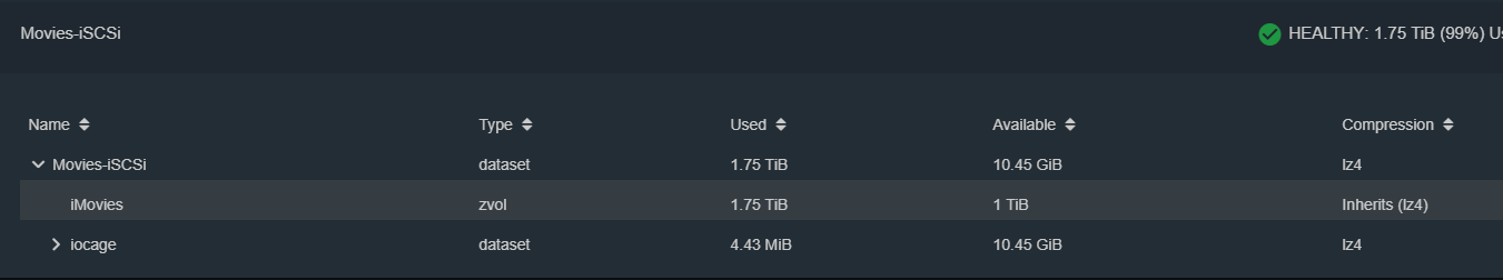

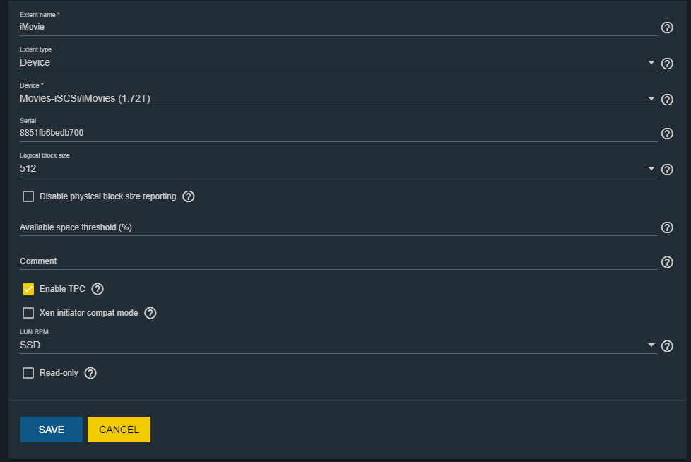

The first iSCSI I set up, I set up a Pool, and created a zvol
Created the Extent using the zvol as the Device.
I was able to connect it to my Windows 10 machine and everything is working.

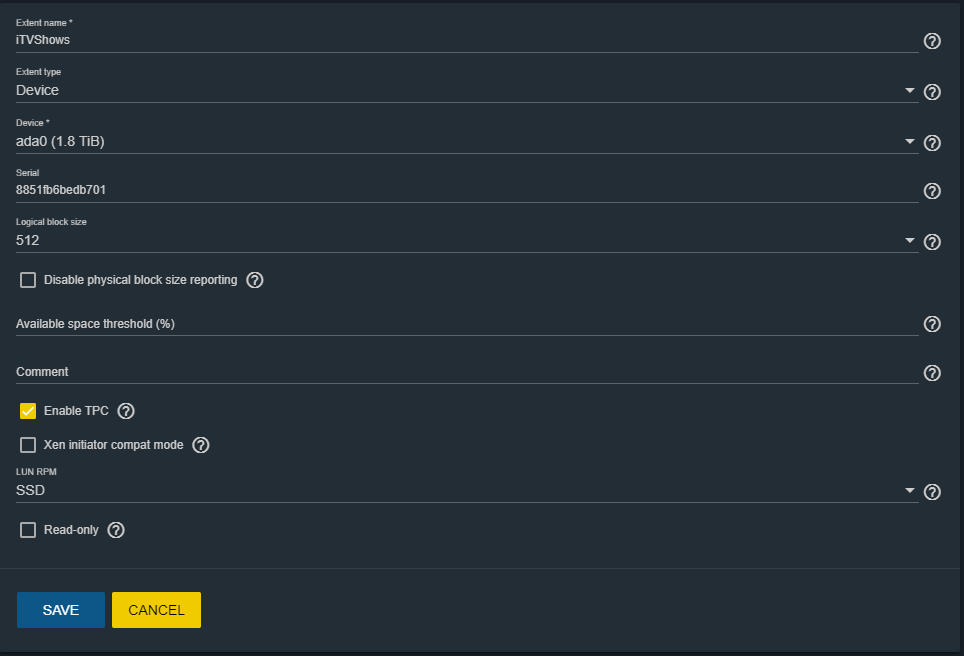

It seemed Messy working with a zvol (I have really not Idea what the best practice are or even what I am doing) and as I was not planing on using a raid setup or extending the volumes as I would be upgrading the drives as I can afford to and they all wouldn't be the same size any more, I set up the iTVShow to use the drive as a device.
This worked. It is connected to my windows machine as a physical drive and working correctly.

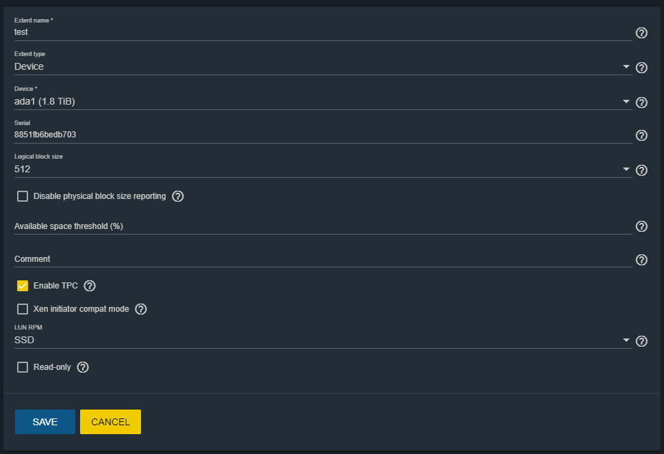

I then proceeded to make a third one that will contain the audio files. I set it up he same way I set up the iTVShows. This gave me the error in windows
I then thought, maybe there was an issue with the drive. The drives I have are used, and there is no guarantee that they would work. I then set up a 4th iSCSI using a 4th drive that I called test.
This also failed with the same error in windows.
I then set up the iAudio with a zvol instead of using the drive as a device, as you can see from the list of extents, and still same result in windows.

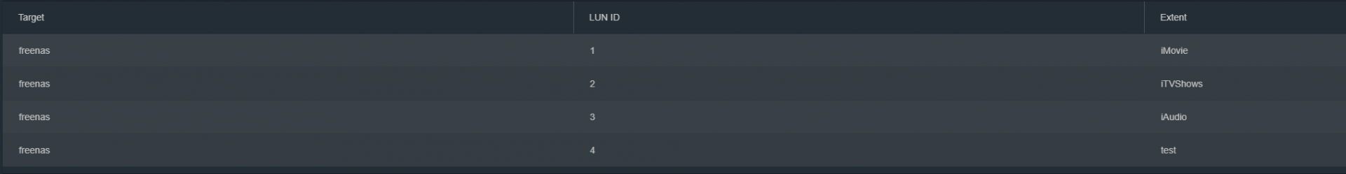

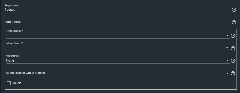

Here are the Associated Targets

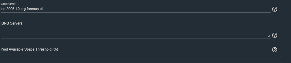

And in case it is important,
Target Global Configuration

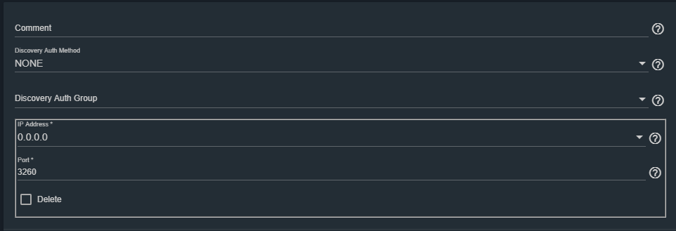

Portals

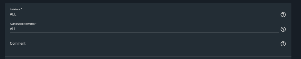

Initiators
No settings were made in Authorized access
And here are the settings for Targets
