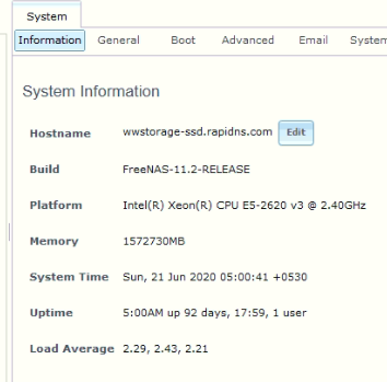

Am I reading that summary right in that there is 1.5T of RAM in that machine? (Nice.)

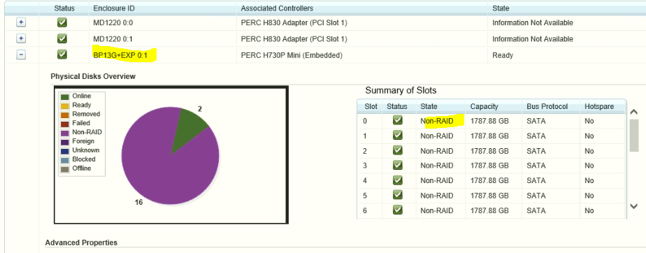

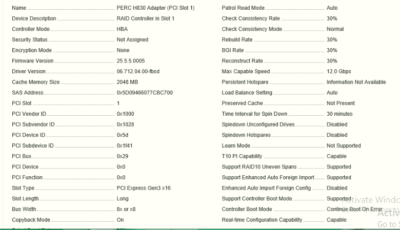

chetan008
Jan 10, 2020
13
Hello Samuel and Honey,
we have using below hardware
Server Model DELL 730xd
1.9 TB SSD disks

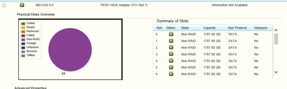

server dell 730x connected with two Dell MD 1220-1 Jbod.
We are using H830 card to pass through MD disks to freenas.

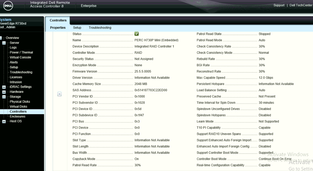

Within local Dell 730XD server we are using H730P Mini raid controller configure in non raid mode
We are using 2x10G intel x540-t2 nic cards in lacp. Please find attached zpool status. and volume information.

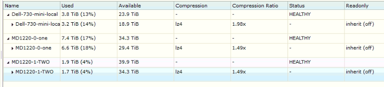

root@#[~]# zpool list
NAME                  SIZE  ALLOC   FREE  CKPOINT  EXPANDSZ   FRAG    CAP  DEDUP  HEALTH  ALTROOT
Dell-730-mini-local  27.8T  3.85T  23.9T        -         -    22%    13%  1.00x  ONLINE  /mnt
MD1220-0-one         41.8T  7.43T  34.3T        -         -    13%    17%  1.00x  ONLINE  /mnt
MD1220-1-TWO         41.8T  1.89T  39.9T        -         -     2%     4%  1.00x  ONLINE  /mnt
freenas-boot          444G   846M   443G        -         -      -     0%  1.00x  ONLINE  -

Yeesh. Your pools are constructed inappropriately for serving iSCSI zvols. First, zvols work best on mirror pools, not RAIDZx pools. You can mitigate some of the performance discrepancy by using SLOG and L2ARC, but none of your pools have this. Second, your RAIDZ2 pools are too wide; beyond 12 disks, you can actually start losing performance. In your case, per zvol writes are taking over 90 seconds to complete.
Since this setup was working before, it's likely your H830 card is going bad, or the cables from the H830 to the MD 1220-1s need to be replace.

I also see you're running the H730 and H830 - as long as they are in true HBA mode that should be fine, but check your firmware revisions, there were several that were flagged as Critical from Dell. (While ZFS and vSAN are very different solutions, they have one thing in common which is that they're both very good at exposing bugs in HBA/controller firmware.)
http://poweredgec.dell.com/latest_poweredge-13g.html#R730XD SAS RAID
Check your backplane firmware as well, in both the head unit and the MD1220s. You may need to connect them to a non-HBA-mode controller temporarily to do this though.

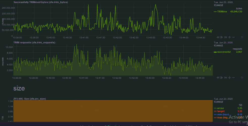

Can you also do camcontrol identify daX on one of those drives? Want to ensure that TRIM is being exposed here.

I can see high arc usage it could be the issue ? since we are having 1.5TB ram hence not using slog and l2arch device.

No, ARC consumption isn't the issue. As @HoneyBadger stated, your pool by construction is limited to the random IOPS of a single drive, and all your drives are thrashing with TRIMs. This is why it's taking over 90 seconds to complete a zvol write. All your pool drives have hit the fragmentation point of no return, and are constantly garbage collecting.
I'm afraid there's no easy fix. You'll have to shutdown your VMs so you can back up the zvols. You'll need to destroy your pool, and then secure erase your SSDs to reset them back to factory. Then you'll have to completely rebuild your pool using stripes of mirrors instead of a single large RAIDZ2 as currently. You may also want to upgrade to 11.3-U3.2, which allows you to underprovision your drives to leave additional space for TRIM to operate.

Can you confirm that you have actually forced the card into full HBA mode and are not simply passing unconfigured disks through as "Non-RAID Disk" in RAID mode?

Dear HoneyBadger,
There are two controllers one is H730P in raid mode local drives of DELL 730XD connected. but drive within this controller configure in non -raid mode. Since in this controller we have configure OS 250GB SSD in raid one mode hence we set this controller in raid mode.
We have attached both MD1220 Jbod to H830 controller which is set in HBA mode. and disks are set to non-raid mode

Neither mrsas nor mfi drivers are used? It should be one of those. Can you run dmesg and find out which driver is being used by your H730P/H830 HBAs?
The H730P being in mixed-mode may not be the best situation either as the controller may still be getting involved. There being no identified driver is very odd though.

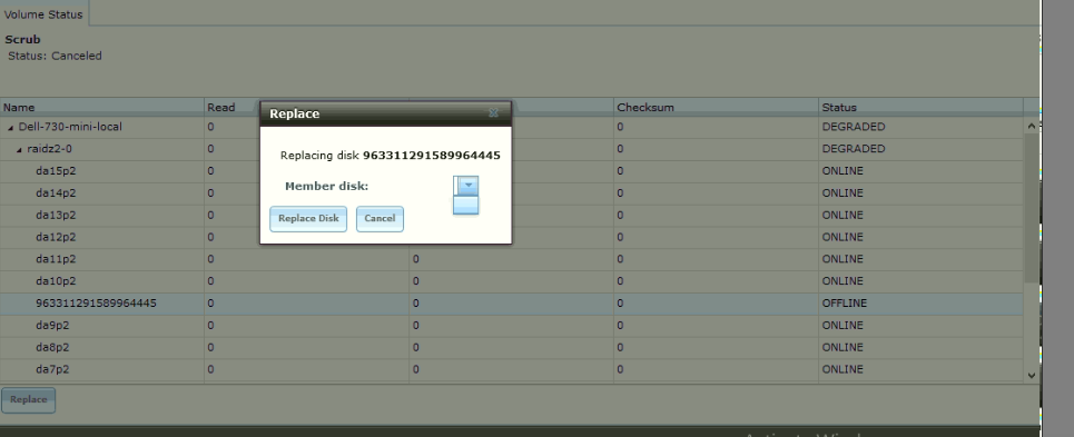

We have replace the disk but new disk not deected in freenas what could be the issue

Dear Samuel Tai,
I have follow same steps offline the failed disk replace the new disk but when we click on replace new disk not showing in drop down box
Raid controller is H730P Mini we have converted disk to non raid its detected in controller but not showing in freenas thats the issue.

Does the new drive appear when you run camcontrol devlist? Since the RAID controller is still involved, this may be something FreeNAS can only detect changes to on boot.
