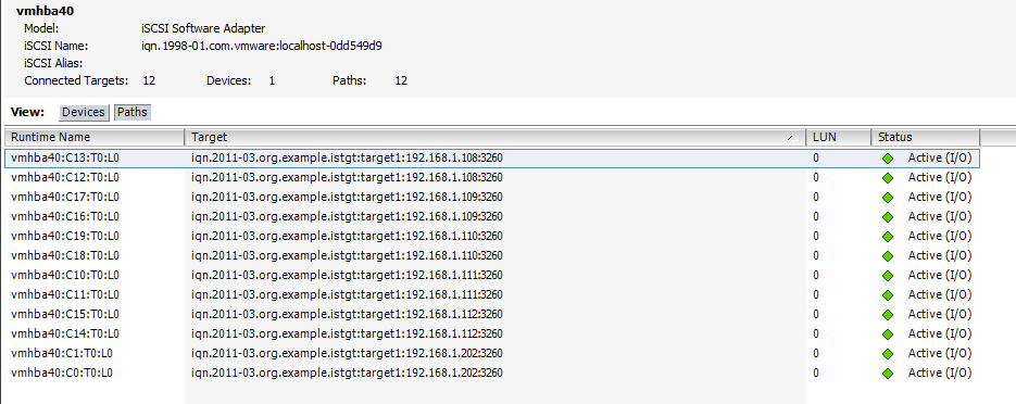

I have the following on the esxi.
But if you look here, it doesnt seem like the traffic is flowing the same through all NICS

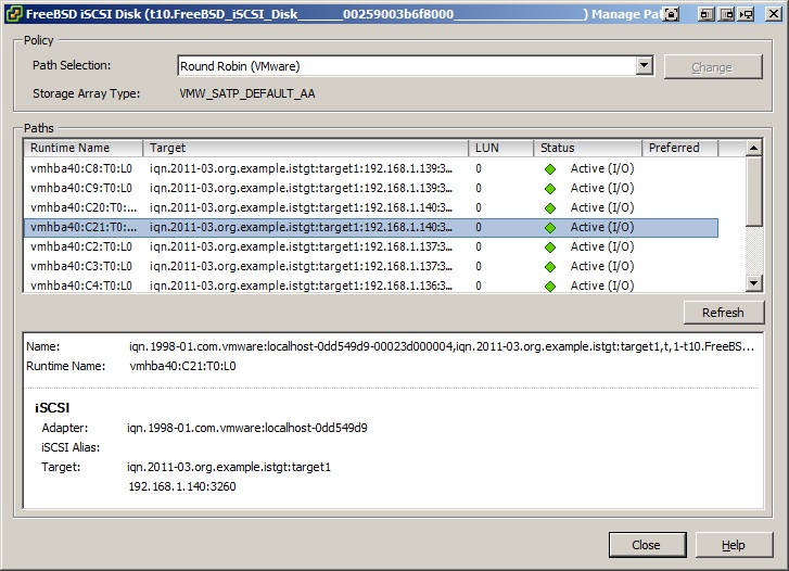

Don't forget to configure the multi-pathing policy on each of your datastores.
Go to the Config tab & select storage to get a list of your datastores. About half-way down the screen on the right of the "Datastore Details" section there is a Properties link in blue. Click that and in the screen that pops up there is a "Manage Paths..." button on the bottom right. Click that and you can change the path selection to "Round Robin". That will allow your iscsi traffic to be spread acroos all the links you have to your storage.

Yep, I always have that setup. Still not sure why im not getting I/O from the box
