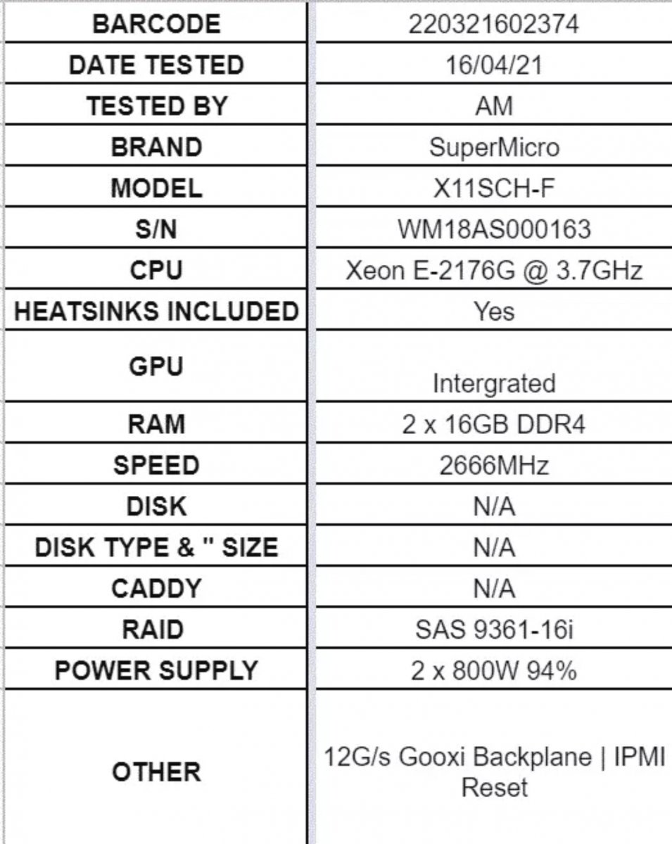

Hey guys I found this server and wondering if price is good?
£559 (~$778)
Supermicro X11SCH-F
Xeon E-2176G
sas 9361-16i
32 GB Ram
It comes in a slightly worn and marked rack
See image for other details

Ignoring those parts - is the board, CPU and 2U chassis with 12 disk slots a good deal?

Whether or not the chassis and board is a good deal is mostly a matter of perspective. With the higher clock speed CPU, it would be good at SMB or other single-threaded tasks. The board, being a micro-ATX, has very limited expansion options. The chassis, which you didn't specify, doesn't seem to be a Supermicro, so it is hard to estimate value. 32GB of memory might be fine for home use.

Thanks for the replies. The chassis was some cheap Chinese **** so I sent it back
