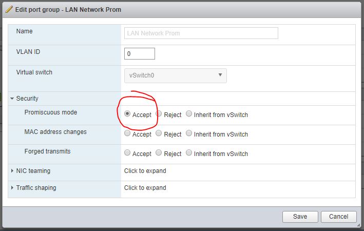

i was having the same issue and symptoms as OP and the other posters with my IOCAGE jails on FN 11.2-RC1 (no network on vnet; yet actual nic works fine), however, mines was due to my recent migration into a FreeNAS VM. after 3 days of troubleshooting, figured out that it was the virtual switch/NIC causing the problem. vnet0 requires "promiscuous mode" to be enabled on the port group. it's disabled by default.
