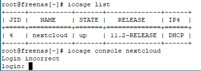

I just set up a new FreeNAS 11.2-U5 that is supposed to run Nextcloud.
Everything is set up and working as it should now, apart from a weird iocage issue.
I SSH into the FreeNAS server, and then try to run iocage console to enter the jail.
I receive a message about incorrect login. Why is that, and how is it even possible?
As a test at created a new iocage jail in the same way as the first one, called test.
I can enter that one with iocage console just as it´s supposed to work.
What has happened with my NC jail? Nextcloud 16.0.1 by the way.
In the attached image you can see what I get in the terminal.

Were you able to resolve this? Which version of Nextcloud? Do you get the same error if you use the Shell icon from that jail?

No resolution as of yet.
Nextcloud 16.0.1 (The latest at the time of installation).
Same error if I use Shell on the jail or if I enter Shell on the FreeNAS level and do iocage console from there.
Any other suggestions or next steps?
I can enter the jail using jexec just fine...
