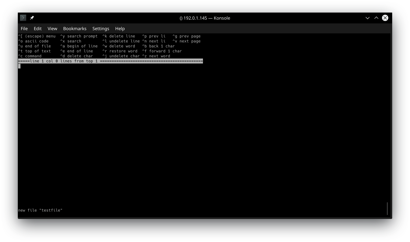

screen to install/update Home Assistant. Everything worked great from the time I made this script back on FreeNAS 11.1-U2, up to and including FreeNAS 11.2-BETA3. Now after upgrading to FreeNAS 11.2-RC1 My script crashes with a message that reads Please set a terminal type..I first thought it was a problem with my script but now I am realizing I cant even do something as simple as edit a text file without first manually setting a terminal type using
setenv TERM vt100I'm not really sure how else to describe this problem so I am including a few screen shots to hopefully help. For now lets forget my script and use a very simple example using
ee.I have created a new jail called
test-jailusing Code:
iocage create -r 11.2-RELEASE boot=on dhcp=on bpf=yes vnet=on -n test-jail
Next I enter the jail console

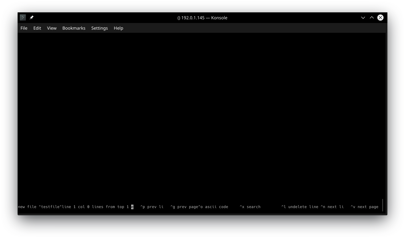

iocage console test-jailNow I try to create a file using
ee testfileAlready I can see something is wrong as the menu is all on one line across the bottom of my terminal
I exit
ee and set the terminal type manually using setenv TERM vt100 and again try creating a test fileNow the editor opens and looks as expected
