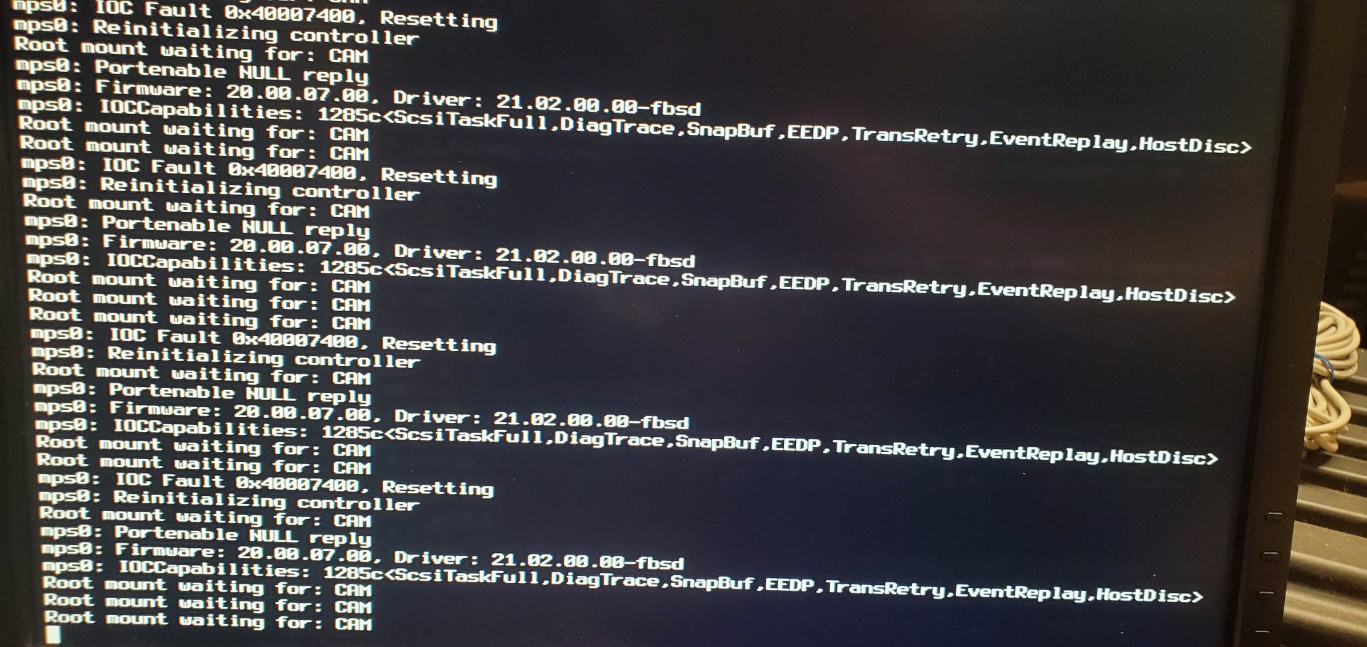

Been messing with this since last night. I tried going through the steps of the flash procedure again (https://tylermade.net/2017/06/27/ho...-lsi-9211-8i-firmware-hba-for-freenas-unraid/), but nothing has changed. I tried reinstalling TrueNAS; the bootable USB spams the same errors (attached image in case I missed anything transcribing).
