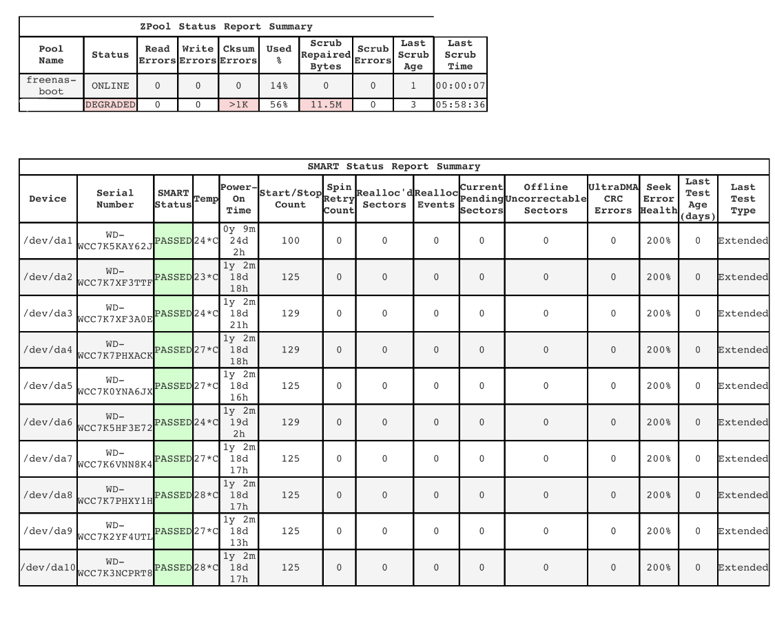

Ok. Well, this was not very insightful... now what?

LIGISTX
Apr 12, 2015
525
Find the disk in question and check the SMART output.
Any specific smart info besides what I showed in the emailed smart report above I should look for? I’m not exactly sure what this is showing me since nothing seems to be wrong.

LIGISTX
Apr 12, 2015
525
I believe this is the smart data from every drive. Still not entirely sure what is wrong, I don’t see anything that looks worrisome.
Suggestions?
########## SMART status report for da1 drive (Western Digital Red: WD-WCC7K5KAY62J) ##########
smartctl 6.6 2017-11-05 r4594 [FreeBSD 11.1-STABLE amd64] (local build)
  1 Raw_Read_Error_Rate     0x002f   200   200   051    Pre-fail  Always       -       0
  3 Spin_Up_Time            0x0027   160   160   021    Pre-fail  Always       -       6958
  4 Start_Stop_Count        0x0032   100   100   000    Old_age   Always       -       100
  5 Reallocated_Sector_Ct   0x0033   200   200   140    Pre-fail  Always       -       0
  7 Seek_Error_Rate         0x002e   200   200   000    Old_age   Always       -       0
  9 Power_On_Hours          0x0032   091   091   000    Old_age   Always       -       7148
 10 Spin_Retry_Count        0x0032   100   253   000    Old_age   Always       -       0
 11 Calibration_Retry_Count 0x0032   100   253   000    Old_age   Always       -       0
 12 Power_Cycle_Count       0x0032   100   100   000    Old_age   Always       -       98
192 Power-Off_Retract_Count 0x0032   200   200   000    Old_age   Always       -       86
193 Load_Cycle_Count        0x0032   200   200   000    Old_age   Always       -       60
194 Temperature_Celsius     0x0022   126   110   000    Old_age   Always       -       24
196 Reallocated_Event_Count 0x0032   200   200   000    Old_age   Always       -       0
197 Current_Pending_Sector  0x0032   200   200   000    Old_age   Always       -       0
198 Offline_Uncorrectable   0x0030   100   253   000    Old_age   Offline      -       0
199 UDMA_CRC_Error_Count    0x0032   200   200   000    Old_age   Always       -       0
200 Multi_Zone_Error_Rate   0x0008   200   200   000    Old_age   Offline      -       0
No Errors Logged
Test_Description    Status                  Remaining  LifeTime(hours)  LBA_of_first_error
Extended offline    Completed without error       00%      7131         -
Short offline       Completed without error       00%      7063         -
########## SMART status report for da2 drive (Western Digital Red: WD-WCC7K7XF3TTF) ##########
  3 Spin_Up_Time            0x0027   167   166   021    Pre-fail  Always       -       6650
  4 Start_Stop_Count        0x0032   100   100   000    Old_age   Always       -       125
  9 Power_On_Hours          0x0032   086   086   000    Old_age   Always       -       10670
 10 Spin_Retry_Count        0x0032   100   100   000    Old_age   Always       -       0
 11 Calibration_Retry_Count 0x0032   100   100   000    Old_age   Always       -       0
 12 Power_Cycle_Count       0x0032   100   100   000    Old_age   Always       -       123
192 Power-Off_Retract_Count 0x0032   200   200   000    Old_age   Always       -       120
193 Load_Cycle_Count        0x0032   200   200   000    Old_age   Always       -       59
194 Temperature_Celsius     0x0022   127   112   000    Old_age   Always       -       23
No Errors Logged
Extended offline    Completed without error       00%     10652         -
Short offline       Completed without error       00%     10585         -
########## SMART status report for da3 drive (Western Digital Red: WD-WCC7K7XF3A0E) ##########
  3 Spin_Up_Time            0x0027   164   164   021    Pre-fail  Always       -       6783
  4 Start_Stop_Count        0x0032   100   100   000    Old_age   Always       -       129
  9 Power_On_Hours          0x0032   086   086   000    Old_age   Always       -       10673
 12 Power_Cycle_Count       0x0032   100   100   000    Old_age   Always       -       127
192 Power-Off_Retract_Count 0x0032   200   200   000    Old_age   Always       -       122
193 Load_Cycle_Count        0x0032   200   200   000    Old_age   Always       -       58
194 Temperature_Celsius     0x0022   126   109   000    Old_age   Always       -       24
No Errors Logged
Extended offline    Completed without error       00%     10656         -
Short offline       Completed without error       00%     10588         -
########## SMART status report for da4 drive (Western Digital Red: WD-WCC7K7PHXACK) ##########
  3 Spin_Up_Time            0x0027   160   160   021    Pre-fail  Always       -       6983
193 Load_Cycle_Count        0x0032   200   200   000    Old_age   Always       -       51
194 Temperature_Celsius     0x0022   123   105   000    Old_age   Always       -       27
No Errors Logged
Extended offline    Completed without error       00%     10654         -
########## SMART status report for da5 drive (Western Digital Red: WD-WCC7K0YNA6JX) ##########
  3 Spin_Up_Time            0x0027   156   156   021    Pre-fail  Always       -       7191
  9 Power_On_Hours          0x0032   086   086   000    Old_age   Always       -       10668
194 Temperature_Celsius     0x0022   123   103   000    Old_age   Always       -       27
No Errors Logged
Extended offline    Completed without error       00%     10651         -
Short offline       Completed without error       00%     10583         -
########## SMART status report for da6 drive (Western Digital Red: WD-WCC7K5HF3E72) ##########
  3 Spin_Up_Time            0x0027   167   167   021    Pre-fail  Always       -       6641
  9 Power_On_Hours          0x0032   086   086   000    Old_age   Always       -       10678
192 Power-Off_Retract_Count 0x0032   200   200   000    Old_age   Always       -       101
193 Load_Cycle_Count        0x0032   200   200   000    Old_age   Always       -       78
No Errors Logged
Extended offline    Completed without error       00%     10661         -
Short offline       Completed without error       00%     10593         -
########## SMART status report for da7 drive (Western Digital Red: WD-WCC7K6VNN8K4) ##########
  3 Spin_Up_Time            0x0027   161   161   021    Pre-fail  Always       -       6908
  9 Power_On_Hours          0x0032   086   086   000    Old_age   Always       -       10669
194 Temperature_Celsius     0x0022   123   106   000    Old_age   Always       -       27
No Errors Logged

########## SMART status report for da8 drive (Western Digital Red: WD-WCC7K7PHXY1H) ##########
  3 Spin_Up_Time            0x0027   164   164   021    Pre-fail  Always       -       6766
194 Temperature_Celsius     0x0022   122   105   000    Old_age   Always       -       28
No Errors Logged
Short offline       Completed without error       00%     10584         -
########## SMART status report for da9 drive (Western Digital Red: WD-WCC7K2YF4UTL) ##########
  3 Spin_Up_Time            0x0027   169   169   021    Pre-fail  Always       -       6541
  9 Power_On_Hours          0x0032   086   086   000    Old_age   Always       -       10665
193 Load_Cycle_Count        0x0032   200   200   000    Old_age   Always       -       44
No Errors Logged
Extended offline    Completed without error       00%     10647         -
Short offline       Completed without error       00%     10343         -
########## SMART status report for da10 drive (Western Digital Red: WD-WCC7K3NCPRT8) ##########
  3 Spin_Up_Time            0x0027   162   162   021    Pre-fail  Always       -       6866
193 Load_Cycle_Count        0x0032   200   200   000    Old_age   Always       -       39
No Errors Logged

That "PASSED" is a useless indicator. I have only ever seen ONE drive out of literally hundreds that was even able to respond to commands that didn't say PASSED even when it had hundreds or even thousands of errors. A drive will still say it is PASSING as long as it is usable at all, even if it has bad sectors and long delays from read retries. I don't even look at that.
Chris Moore
May 2, 2015
10,080
Check glabel status to find out exactly which drive is indicated by
gptid/b04ad4fc-44ea-11e8-8cad-e0071bffdaee
Then, if you would, share the full output of smartctl -x /dev/daX and we can take a look to see if there is some indicator that shows a drive fault.

I did (I think) provide the smart output from every drive in the array a few posts up, I believe before the one I tagged you in. Unless that wasn’t the correct info? To me it looked like they all read the same. But when I get home I will try this as well.
Chris Moore
May 2, 2015
10,080
The command smartctl -a gives less detail than smartctl -x and you didn't provide all the data that smartctl -a would and I am only interested in the drive that is being a problem.

I thought I had provided the -a info, but either way, I don't see much wrong with this either... Do you see anything in here that indicates an issue? I don't see any reallocated sectors or rear or write errors/ retry's etc.
https://pastebin.com/9PqRaHL8
So, uh, by "not needing to do anything", what do you mean exactly?
Also, I am running another long test just to make double sure this test was indeed ran over the weekend as it appeared to via my emailed status, and as it should have via freenas webui. But, I figure best to just make sure...
