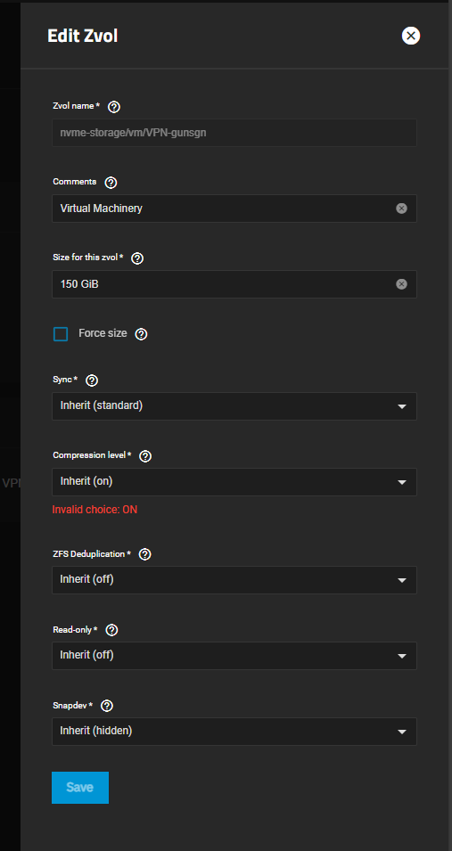

If you try to edit a ZVol then you get a message saying ON is an invalid choice for compression, even though that is what is currently set.

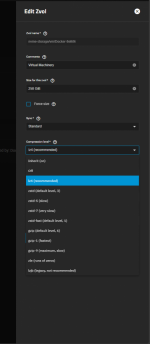

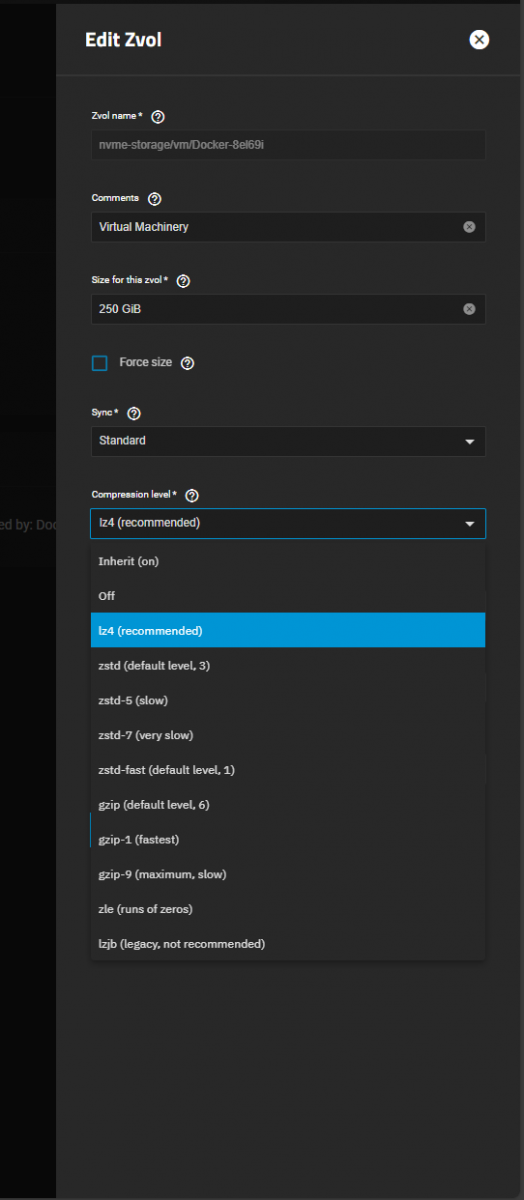

Actually no, these are two brand new zvols as I try to recreate my VM's onto UEFI BIOS settings. So they were created on Cobia. I had got them both up and running, but then decided to make them larger so struck this when I went to edit them.
In the list of options LZ4 was Recommended so I manually changed them both to LZ4. otherwise I would not have been allowed to edit .

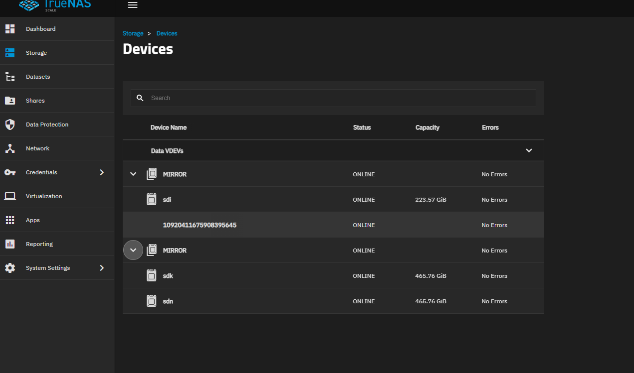

Checked on it myself - it appears that the nvme-storage pool was created manually?
zpool create -f nvme-storage /dev/nvme0n1p5
Trevor68
Oct 15, 2021
130
It may well have been, which would explain why it is different, I have a terrible memory! I think I may have done that because it uses a partition of my nvme drive and a ssd as the mirror. Originally I did not want to waste the entire nvme drive so I partitioned off 32gig for my boot drive.
This would make me very much an edge case so sorry for wasting your time! :oops:
