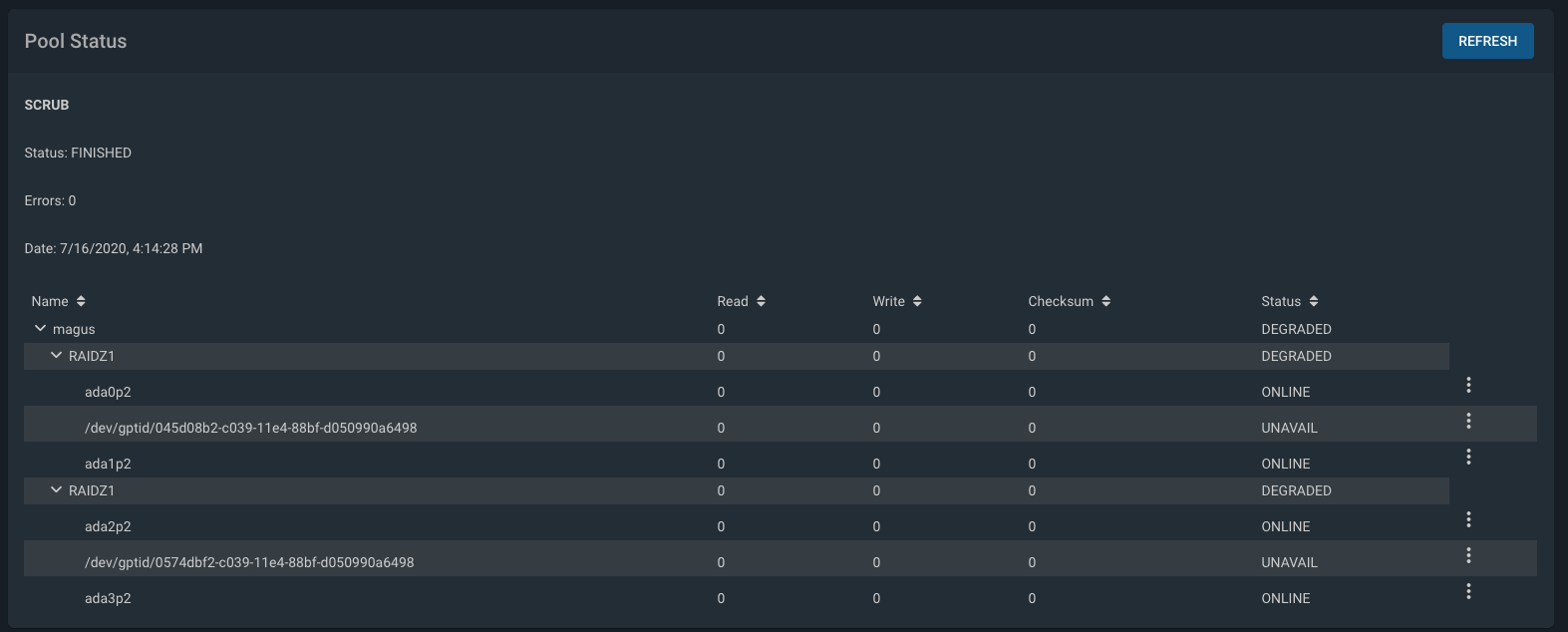

root@freenas:~ # zpool status
pool: freenas-boot
state: ONLINE
scan: scrub repaired 0 in 0 days 00:02:18 with 0 errors on Mon Jul 13 03:47:18 2020
config:
NAME STATE READ WRITE CKSUM
freenas-boot ONLINE 0 0 0
da0p2 ONLINE 0 0 0
errors: No known data errors
pool: magus
state: DEGRADED
status: One or more devices could not be opened. Sufficient replicas exist for
the pool to continue functioning in a degraded state.
action: Attach the missing device and online it using 'zpool online'.
see: http://illumos.org/msg/ZFS-8000-2Q
scan: scrub repaired 0 in 0 days 01:21:33 with 0 errors on Thu Jul 16 17:36:01 2020
config:
magus DEGRADED 0 0 0
raidz1-0 DEGRADED 0 0 0
gptid/03e42fa2-c039-11e4-88bf-d050990a6498 ONLINE 0 0 0
16623217734093965384 UNAVAIL 0 0 0 was /dev/gptid/045d08b2-c039-11e4-88bf-d050990a6498
gptid/04bb3813-c039-11e4-88bf-d050990a6498 ONLINE 0 0
gptid/04bb3813-c039-11e4-88bf-d050990a6498 ONLINE 0 0 0
raidz1-1 DEGRADED 0 0 0
gptid/0515b5cd-c039-11e4-88bf-d050990a6498 ONLINE 0 0 0
