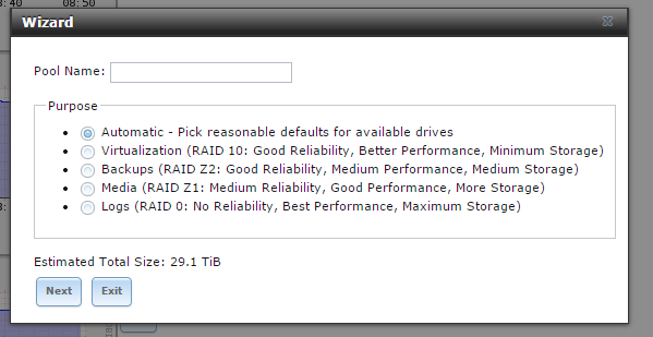

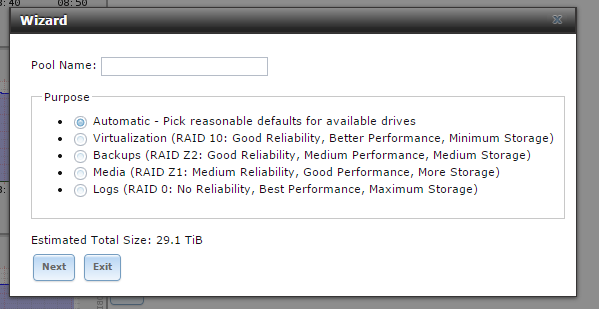

depasseg
FreeNAS Replicant
Sep 16, 2014
2,874
Write workload. Read workloads with RAIDZn are generally fine but may be faster with mirrors. It is the write workload which is truly problematic. And you're exaggerating, though I appreciate the sentiment.
I'll quote something like that back at you the next time you say ZIL when you mean SLOG. ;-)
And who put RAID10 in the Wizard? :smile:
