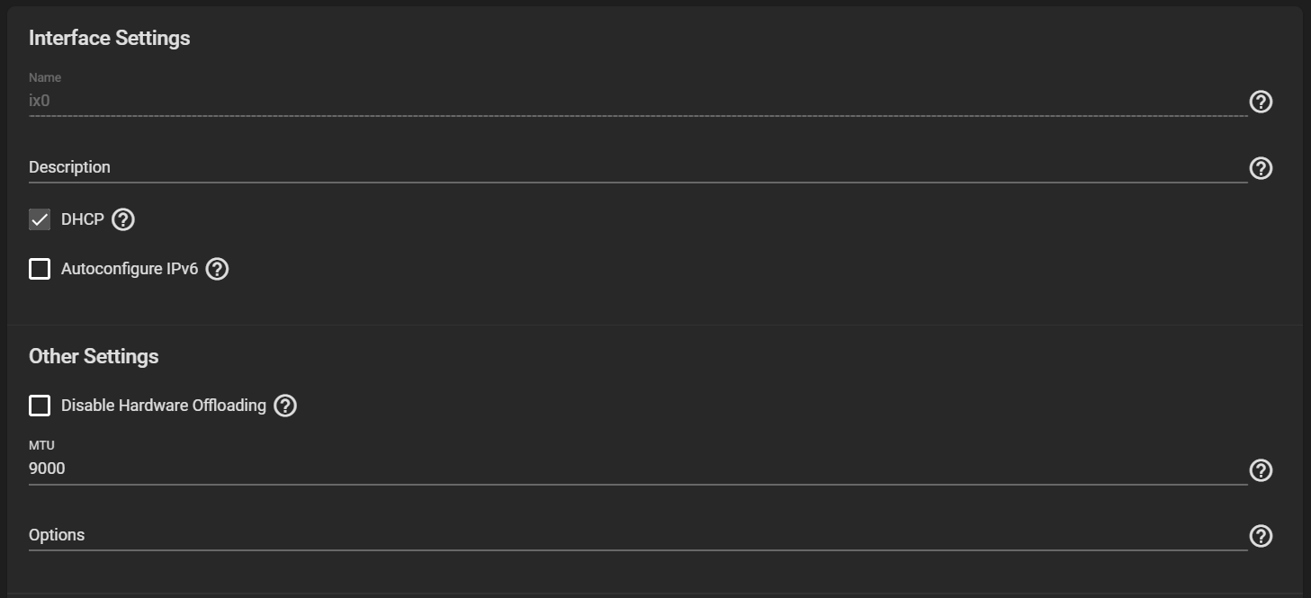

The problem I'm seeing, is that the transfer speeds have slowed to a crawl since changing from the intel pro 1000 card I had before. I could easily top to 100 MB/sec. Now, the new intel card gives me more or less 30-35 MB/sec which I don't really get. In the Network/Interfaces configuration, I can see:
Active Media Subtype:
Unknown
That bothers me because it feels like it's not negotiating speed at 2.5 Gbps, which the card is supposed to be fully compatible too. It's connected to the router with a Cat 7 cable, I've also tried with a Cat6 cable and I get the exact same results.
Do you think I'm missing anything here? I also do have jumbo packets enabled on both ends.
Thanks!
