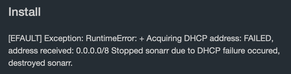

I then tried to create a new iocage Sonarr plugin using DHCP
Unfortunately the create process failed because it was unable to get a DHCP address
The following is a copy of the StdOut : -
undefinedDec 7 15:38:27 fnplex epair17a: Ethernet address: 02:f1:d0:00:1b:0a
Dec 7 15:38:27 fnplex epair17b: Ethernet address: 02:f1:d0:00:1c:0b
Dec 7 15:38:27 fnplex kernel: epair17a: link state changed to UP
Dec 7 15:38:27 fnplex kernel: epair17b: link state changed to UP
Dec 7 15:38:27 fnplex kernel: epair17a: changing name to 'vnet0:19'
Dec 7 15:38:27 fnplex kernel: epair17b: changing name to 'epair0b'
Dec 7 15:38:27 fnplex kernel: vnet0:19: promiscuous mode enabled
Can anyone please help explain what is going on here and how I can resolve the problem.

Just a bit of an update on my progress with this problem.
I have a test machine that runs on an older HP N40L where I have been trying out the various versions of 11.2 and which yesterday I upgraded to the release version of 11.2. This was originally an 11.1 install, so unlike my production box, had not b been upgraded from 9.10.2
On the test machine I have been able to install plugins without a problem. I have just installed another plugin just to make sure it is not an issue with the release version of 11.2
On my main machine I have also created an empty jail without a problem obtaining a DHCP address
In comparing the network setups on both boxes, I have only noticed two differences: -
1. There is an IPMI section on the main box. I presume because HP's iLO4 service is built in.
2. No network interface was defined. I have therefore added the bge0 interface. Creating the Sonarr plugin still fails, although I am getting additional output to StdOut - see below.

I appear to have solved my problem.
What I failed to do after adding the Network Interface entry was reboot the system.
Having now rebooted, I can now create the Sonarr plugin.
