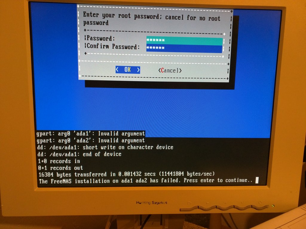

In the process of fortifying my FreeNAS setup I have purchased a pair of NOS mSATA SSDs (Sandisk sdsa5dk).
I intend to install FreeNAS onto them (mirror) and ditch the single USB-stick the rig is currently running off.
Now here it gets interesting.

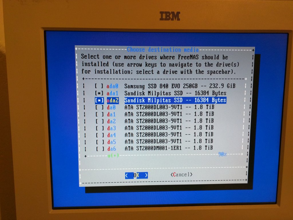

Inside the installer I select the desired drives, in my case ada1 and ada2.
Notice anything od? Yep, the reported size of the drives is tiny, e.i. wrong.
Ignoring, and moving on to the next steps:
- Accepting the warning that this will erase all data yada yada yada...
- Entering root password.
- Twice.
- OK.
Aha!
FreeNAS complains. Somehow my 16Gig SSDs are not to the liking of FreeNAS.

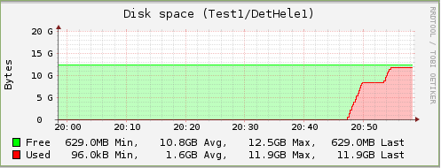

If I reboot into the current working FreeNAS installation, I can mount the said drives and load'em to capacity.
They check out as 16Gig-ish devices with burstrates of around the 100meg/sec mark and a sustained steady state rate of 40-50 megs/sec.
