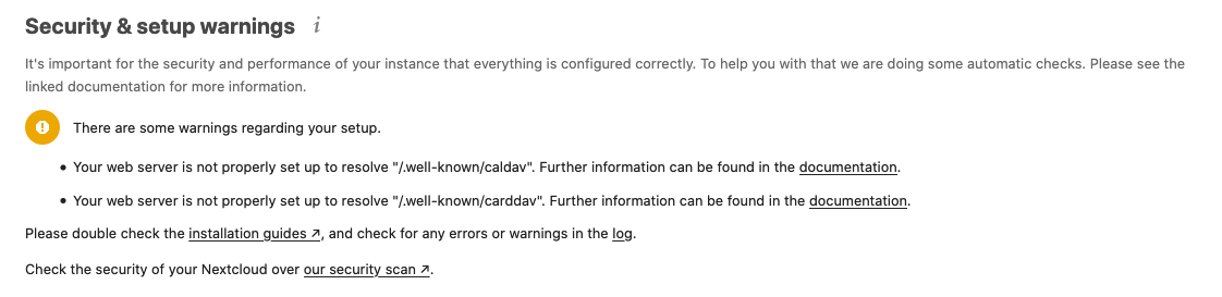

There are some warnings regarding your setup. Your web server is not properly set up to resolve "/.well-known/caldav". Further information can be found in the documentation. Your web server is not properly set up to resolve "/.well-known/carddav". Further information can be found in the documentation.

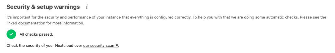

Good guide. I fixed all those but a way more cumbersome process than described here.The only one i struggle with is this:
Code:There are some warnings regarding your setup. Your web server is not properly set up to resolve "/.well-known/caldav". Further information can be found in the documentation. Your web server is not properly set up to resolve "/.well-known/carddav". Further information can be found in the documentation.
I read the explanation but so far, is not getting me anywhere![]()

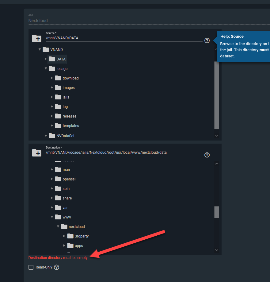

still got one problem adressing storage outside the jail :
In the Detination i point to :
/mnt/VNAND/iocage/jails/Nextcloud/root/usr/local/www/nextcloud/data
- But il tells me that the directory must be empty...
Any advice appreciated :)

Hi Fahadshery,
After go thru your great guideline, i still left these 2 error with my next cloud, do you have any idea how to solve it?
Thank you.

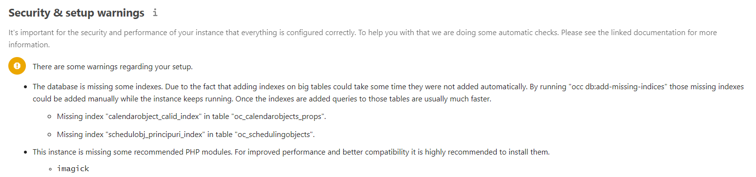

So I finished installing it and follow everything exactly the same as the guide. I then get this message at the end.
Does anybody know of a way to fix this issue?
- This instance is missing some recommended PHP modules. For improved performance and better compatibility it is highly recommended to install them.
- bcmath
- gmp
- imagick
I am running version 19 but it's still there. What about the other 2: bcmath and gmp?From w
From what i understand there are some security vulnerabilities with imagick which appears to be the reason that the NC plugin doesn't install it. I have ignored it to date and read somewhere that imagick might well be gone permanently in version 19.
I install those using the pkg install command from the jail shell. I didn't notice any differences after doing so though. The biggest issue i have with NC19 is that the photos app doesn't work properly, unlike the gallery app in 17 and 18.I am running version 19 but it's still there. What about the other 2: bcmath and gmp?
Can you provide the exact code for the installation. I have gone thru your post here https://www.ixsystems.com/community...-install(bcmath-gmp).85711/page-2#post-593554 but didn’t understand much.I install those using the pkg install command from the jail shell. I didn't notice any differences after doing so though. The biggest issue i have with NC19 is that the photos app doesn't work properly, unlike the gallery app in 17 and 18.
