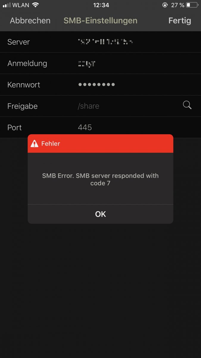

Just to be sure, i created a new dataset, 'sync_folder', i created a new user 'sync'. Under permissions for 'sync_folder' i added 'sync' as the user and applied that permission.
When i try to connect via SMB in the PhotoSync app i put in my server, the sync user and password and the location of the 'sync_folder'. on selecting Done it returns a 'SMB Error. SMB server responded with code 7'
I cant find any where what code 7 is?
Any guidance on this would be apreciated.

I can't find any where what code 7 is?
Yesssss, same over here! This error is driving me nuts for weeks now! :mad:
FreeNAS machine is working perfectly no SMB issues but if I want to use the app Photosync (v3.2.7) to upload photos from my iPhone to FreeNAS via SMB I'm stuck with this error. I can't get no satisfaction connection to FreeNAS everytime there's just this error popping up...
Any help is very much appreciated. Thanks! :)
That's not a very helpful error message. Try downloading a debug file (system->advanced->save debug) and looking in log/samba4/log.smbd. It might give a better idea about what's going on.

Mr. Slumber
Mar 10, 2019
182
I enabled "SMB 1 support" under "Services/SMB"... Now the "SMB error code 7" is gone but I'm getting "530: User not logged in. Permission denied" via the Photosync app.
But this same share is working perfectly fine with VMs, Windows and Ubuntu Laptops. Just not working with Photosync...
Okay. The fact that the error code changed indicates that the app might be SMB1 only. Are you using password auth for the share?

bdl
Jun 21, 2017
3
Okay. The fact that the error code changed indicates that the app might be SMB1 only. [...]
I can verify that PhotoSync on iOS uses SMB1. I just experienced the same issue on my Ubuntu box that had SMB1 disabled, and following the instructions at http://blog.robtherock.de/how-to-re...n-ubuntu-18-04-i-e-for-scanners-and-printers/ made PhotoSync's SMB on iOS work fine.
Haven't had a chance to update my FreeNAS box as yet, but re-enabling SMB1 definitely fixed the SMB issue with PhotoSync.
