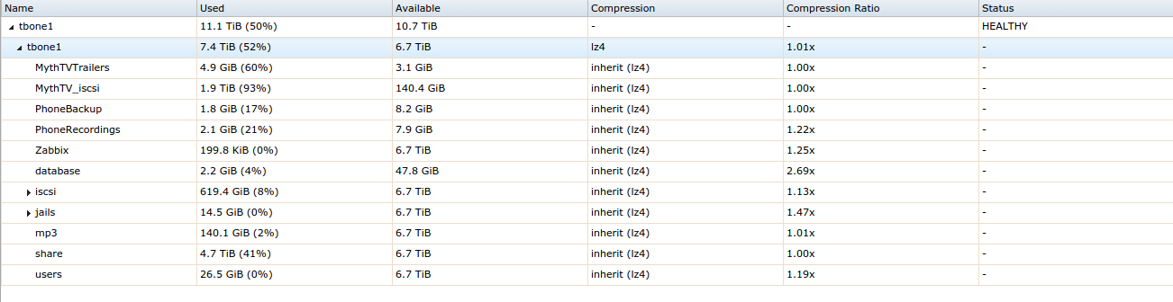

And I just took a screenshot of what my pool list looks like in the GUI. I understand that I loose some to parity since my disks are setup like this
12 2TB disks
I then created 1 raidz2 with the first 6 disks then I extended the zvol into 2nd set of disks in a raidz2 so now I can handle 4 drive failures.
According to http://wintelguy.com/raidcalc.pl I should have 16T of total usable space. I know that I have allocated some of it off to various places with quotas like for example my mythtv backend storage (2TB) is kept here on an iscsi mount (which the performance of that over my previous setup with nfs is amazing). So I get with that why I wouldn't see the full 16TB since 2TB is being used up by myth.
For some reason now on my local box my share is now showing up as 12TB of total storage however mp3 and users still only report in at 6.7TB so I don't know what I did to make the share check in at a better amount than it did before. Continuing to research and what not but if anyone has any tips please feel free to point me in that direction.

gpsguy
Active Member
Jan 22, 2012
4,472
It's been so long, I forgot you had 2 vdev's of 6 drives each. One of the "problems" you have is the age old issue, wherein the drives manufacturers don't use the same numbering system that most OS's use. So FreeNAS, Windows, etc. only sees ~1.8TiB of space. At best, you'd start out with ~14TiB, before substracting any overhead for FreeNAS.
See @Bidule0hm calculator - https://forums.freenas.org/index.php?threads/zfs-raid-size-and-reliability-calculator.28191/
Instead of putting in 12 disks, 2TB disks with RAIDz2 - use 6 and multiple the results by 2.

141
Thank you that would explain the 12T that my share is now reporting. Just weird that the screenshot shows so much but the datasets don't show the same.

Bidule0hm
Server Electronics Sorcerer
Aug 5, 2013
3,710
What you see on the first line of the screenshot is the total space, including parity and ZFS overhead.
