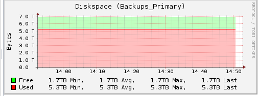

Hi all,
I have a problem with a FreeNAS server that I built. The useable space is not anywhere near what it should be... I have same useable space as my other 6x 2TB disks RAIDz2 pool...
I have 8x 2TB drives in a vdev in RAIDz2. I lose 2 drives for the parity, so 6x2TB. That's 12TB. here's what my volume looks like...
I searched the forums to find ways to see what is in my pool. here 's output of zpool status:
NAME STATE READ WRITE CKSUM
Backups_Primary ONLINE 0 0 0
raidz2-0 ONLINE 0 0 0
gptid/147f988d-ad8e-11e5-b02b-0013726680b4 ONLINE 0 0 0
gptid/152cab87-ad8e-11e5-b02b-0013726680b4 ONLINE 0 0 0
gptid/15d98097-ad8e-11e5-b02b-0013726680b4 ONLINE 0 0 0
gptid/c3ba38af-b4bf-11e5-b058-0013726680b4 ONLINE 0 0 0 (resilvering)
raidz2-1 ONLINE 0 0 0
gptid/1741c8fe-ad8e-11e5-b02b-0013726680b4 ONLINE 0 0 0
gptid/17f260be-ad8e-11e5-b02b-0013726680b4 ONLINE 0 0 0
gptid/18a29ca9-ad8e-11e5-b02b-0013726680b4 ONLINE 0 0 0
gptid/19510b03-ad8e-11e5-b02b-0013726680b4 ONLINE 0 0 0
However, zpool list gives me:
NAME SIZE ALLOC FREE CAP DEDUP HEALTH ALTROOT
Backups_Primary 14.5T 10.9T 3.65T 74% 1.00x ONLINE /mnt
I'm at lost here... I thought I would have something around 10TB to use.

No... you have a pool consisting of two 4-drive RAIDZ2 vdevs. Right now, you have 4 drives for storage and 4 for parity, which makes your free space make sense.
If you want a single 8-disk RAIDZ2 vdev, you'll need to rebuild.

You don't have a RAIDZ2 of 8x2TB drives in a RAIDZ2. You have 2 vdevs of 4 disks in RAIDZ2. So you've lost 4 disks to redundancy (2 disks in each vdev).
