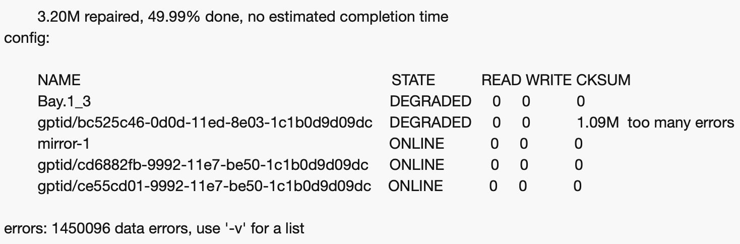

I've gone ahead and deleted the snapshots. I've tried different ports as well, Zpool status gives me:
As for the moving data--I've tried getting it off using SMB, with I/O errors. Should I wait for it to finish scrubbing and then try to move it? Would I add a blank disk to a separate pool and then do zfs send/receive? How can it self repair if the disk it was (supposed to be) mirroring is no longer in the pool? Can I interrupt the scrubbing and shut the system down?

My pool status now looks like:
root@freenas[~]# zpool status
pool: Bay.1_3
state: DEGRADED
corruption. Applications may be affected.
action: Restore the file in question if possible. Otherwise restore the
entire pool from backup.
see: https://openzfs.github.io/openzfs-docs/msg/ZFS-8000-8A
scan: scrub in progress since Mon Aug 1 23:59:53 2022
2.68T scanned at 1.96M/s, 2.68T issued at 1.95M/s, 4.93T total
66.6M repaired, 54.27% done, no estimated completion time
config:
NAME STATE READ WRITE CKSUM
Bay.1_3 DEGRADED 0 0 0
gptid/bc525c46-0d0d-11ed-8e03-1c1b0d9d09dc DEGRADED 0 0 79.4M too many errors (repairing)
mirror-1 ONLINE 0 0 0
gptid/cd6882fb-9992-11e7-be50-1c1b0d9d09dc ONLINE 0 0 0
gptid/ce55cd01-9992-11e7-be50-1c1b0d9d09dc ONLINE 0 0 0
errors: 2423724 data errors, use '-v' for a list
