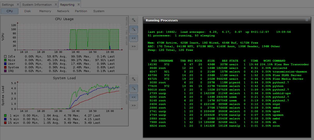

this are the readings that im getting, i guess im maxing out the CPU. but im getting 200% usage even with 4mb @ 720p.

That sounds like it's cpu bound then. :(

Unfortunately looking at the CPU usage % is not going to tell the whole story since the Plex New Transcoder is configured to encode ahead of the streaming and cache the result to disk to stream from. So it will often use up as much CPU as is available and then finish the encode well before the video is done streaming so even if it were encoding slower it would still be able to keep up.
Plex is definitely tuned for a lowest common denominator setup to use low CPU usage for people with slower dual-core CPUs and there is a lot of additional quality you can get out of it when you tweak the encoder. For example Plex by default is only using the "veryfast" x264 preset which quite honestly is not great image quality-wise at lower bitrates like 3-4mbit though of course it is fast which is the point.
Thanks for validating my comment above.
Look at his picture closely. He sits at 100% CPU non-stop while streaming. If he weren't CPU bound it would go to 100% until the buffer filled and then it would be in spurts. The fact that he sat at 100% for almost 30 minutes straight is solid, irrefutable evidence that he IS CPU bound. When you watch my server transcode it goes to 100% for about 20 seconds, then fluctuates from second to second as Plex refills the buffer every few seconds. But, it does NOT bury the needle at 100% CPU usage non-stop.
And since Plex uses the already fast x264 preset you've only provided more evidence that not only is he CPU bound but he can't easily change his options to something that is more CPU friendly.
So thanks for validating me. :)
The user still needs a new CPU. There's a reason why we tell people "if you want to transcode, use encryption, or use high compression you should get a Xeon or at least an i3". Because its a fact based on dozens and dozens of users that have learned this lesson the hard way.
