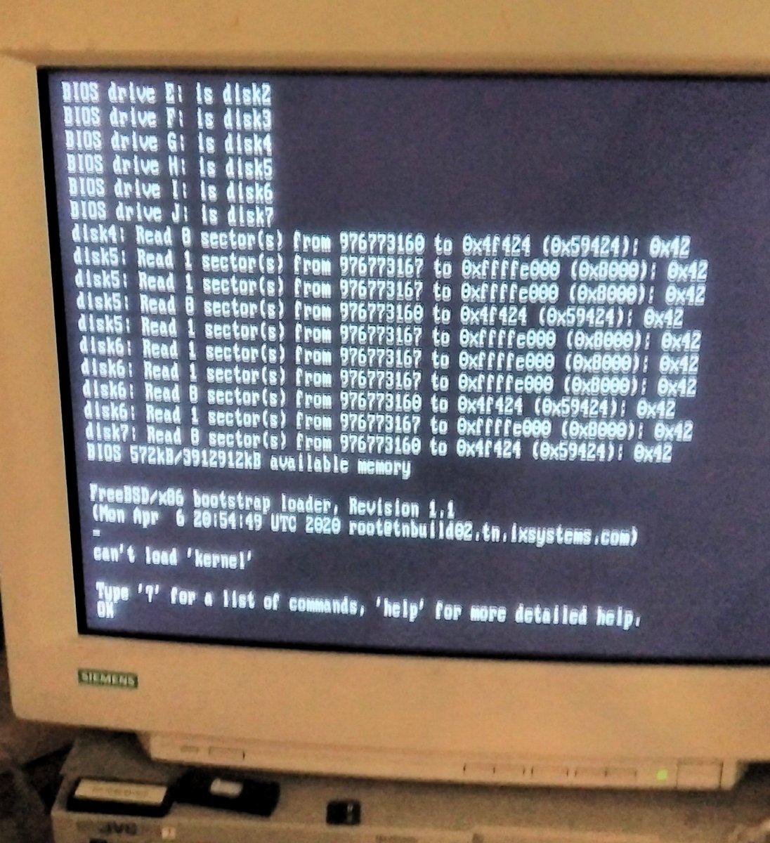

can't load 'kernel' !!!!

Interesting. What's your boot media? If that's USB, it's possible that's your issue. How is it behaving when installing to SSD? I'm assuming MBR boot because "too old for EFI"

This 2006-era beast maxxes out at 8GB RAM. If you do not actually have 8GB RAM in it, I wouldn't be shocked if it didn't run at all. In particular if it only has 1 or 2, "forget it."
I'm a little puzzled at what it is doing. I haven't looked at FreeNAS and its boot strategy lately, but FreeBSD would normally be loading /boot/defaults/loader.conf followed by /boot/kernel/kernel.
You can use "ls" at the loader prompt to see what's out there.
You can use "load /boot/kernel/kernel" (for example) to load that kernel.
