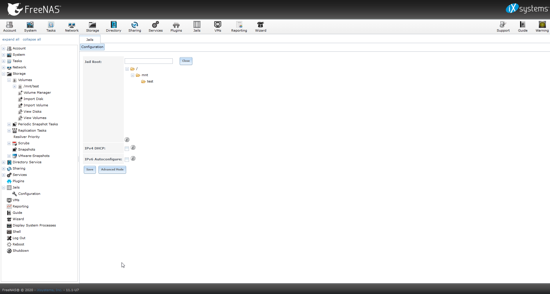

Here is a picture of the GUI where Jail Root can be assigned to the volume. In this case volume "test".
I just did a new install of Freenas 11.1-U7 in a VM as seen on picture.

Yes, I have jails, but nothing for "iocage" specifically. They are listed under the "Jails" tab, but not when I do anything in CLI with "iocage"
I created a new jail, just to see if there was something obvious like an interface name that was off, and the new jail also doesn't get an IP address.
