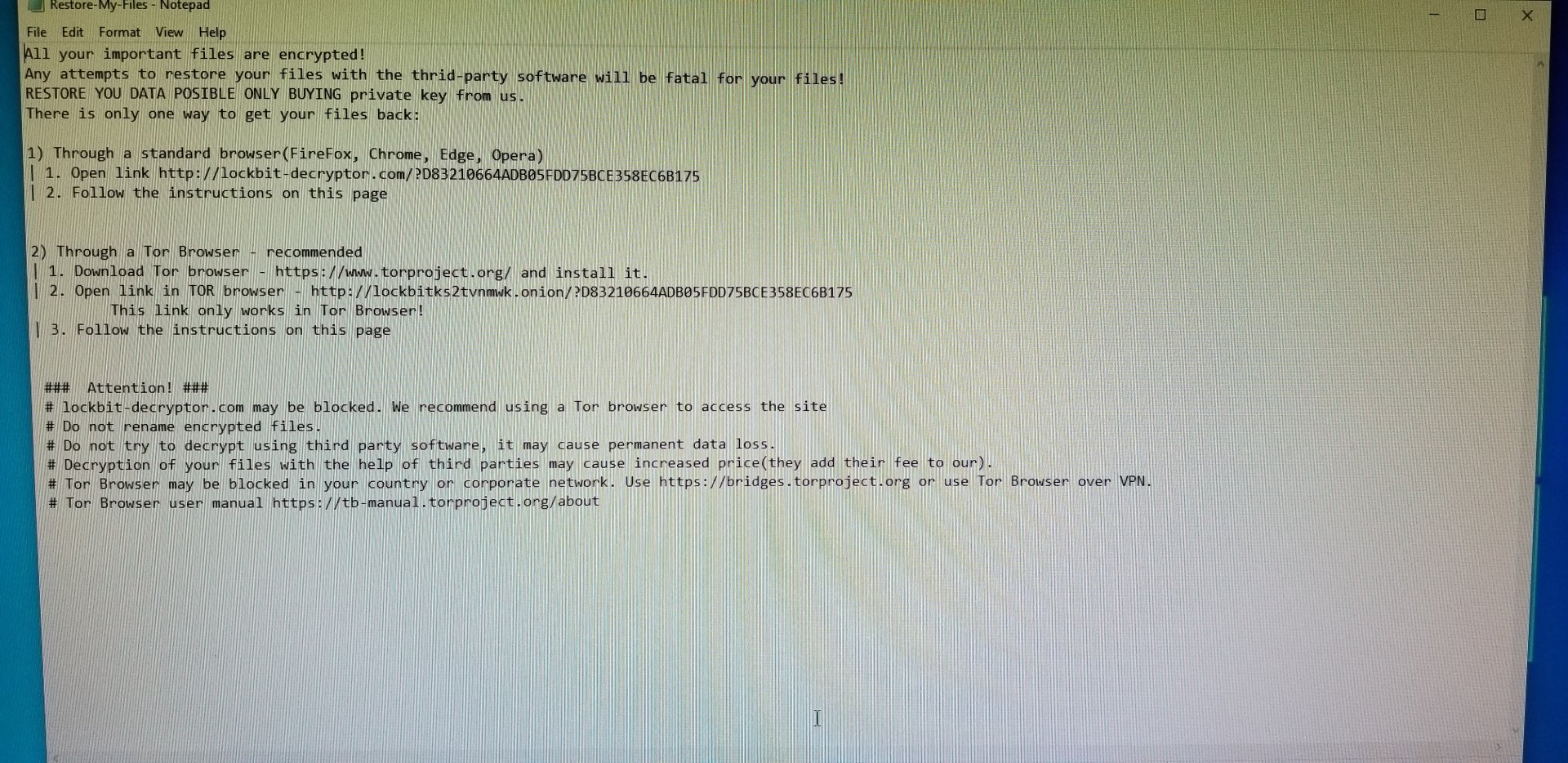

2 days ago my 9 yr. old son unknowingly clicked on a popup from either one of those .io games or through Roblox somehow. I don't know exactly where it came from, but he clicked it and WHAM... all files on my computer, networked computers and my shared FreeNAS folders got locked/encrypted (*.locked extension) with the txt file that I took a snapshot of (attached). Luckily I almost immediately noticed because the movie I was watching on EMBY stopped playing - because those files got nailed too! Did some digging, found the files (*.locked) and that txt file at that time.
