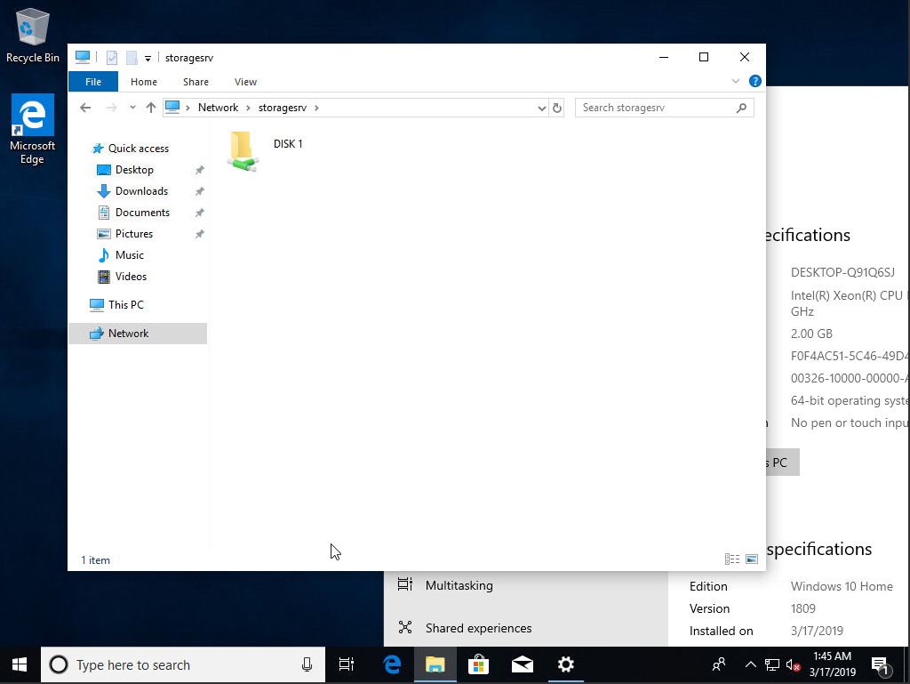

Right, I'll reiterate that this just isn't the case. You don't need to join a computer to a domain in order to use file sharing services. The pro version is for management, policies, and all sorts of other advanced things that you probably don't need (yet), and isn't a concern. Home computers can connect just fine, it simply won't be automatically authenticated.
Here's what that looks like, if you tick "Remember my credentials" then Windows will automatically try to reuse the username and password next time:
Note that you may need to prefix the domain name as I did, or the name of the server proper, depending on your network setup. :)

  2. Share points on the backup server need to be created in advance.
  3. Check that the data on the backup server is read-only (zfs set readonly=on).
  4. To minimise data loss, carefully review the frequency of periodic snapshots and ensure replication is occurring during periods of user activity.
What was a surprising finding in working through this small business scenario, is that when there is a failure of the active server, whether it is the hardware or pool, the boot device of the failed active server is switched across to the backup server. Switching the software state of the backup server's boot device from backup to active is not the preferred default action. Doing so, it appears, complicates returning to the status quo.
Follow up
This review has spawned two other posts around AD and namespace services like DFS. When considering a standby server, the discussion has revealed that these complementary services provide some tangible benefits. What I'm curious to know is 'Can these services be provided without involving a Microsoft Server backend?'.
