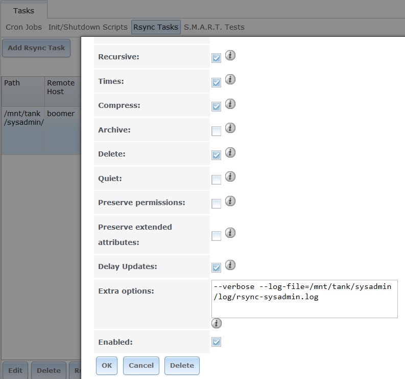

Rsync fails when copying Windows datasets with the '-p' ('Preserve Permissions') option. And there are no plans to implement this option in the future, because "rsync targets primarily unix-like systems." Frankly, I don't blame the rsync team one bit for avoiding the Windows nightmare. :smile:
By implication, the '-p' option not working means the '-a' (Archive) and '-A' ('Preserve Extended Attributes') options are broken, too. From the rsync guide, here are the three options to be avoided:
-a, --archive   equals -rlptgoD (no -H, -A -X)
-p, --perms     Preserve permssions
-A, --acls     Preserve ACLs (implies -p)
This doesn't mean you can't use rsync! It just means you have to avoid using these particular options for Windows datasets. And, of course, live with any resulting consequences.
In shell scripts I use the fully enumerated' -a' option set, leaving off the 'p', like this: -rltgoD
For Rsync Tasks in the GUI, uncheck the 'Archive:', 'Preserve permissions:', and 'Preserve extended attributes:' selections:
I've been using both shell scripts and Rsync Tasks configured this way for nearly a year with good results, so it's not like rsync is unusable.

No matter how you use rsync -- via the GUI or from a shell script -- it's not going to copy Windows permissions; that's the subject of this thread. So I doubt it will have any better success with domain permissions.
Your best bet, once the files are copied to the new server, may simply be to manually reconfigure the permissions.
